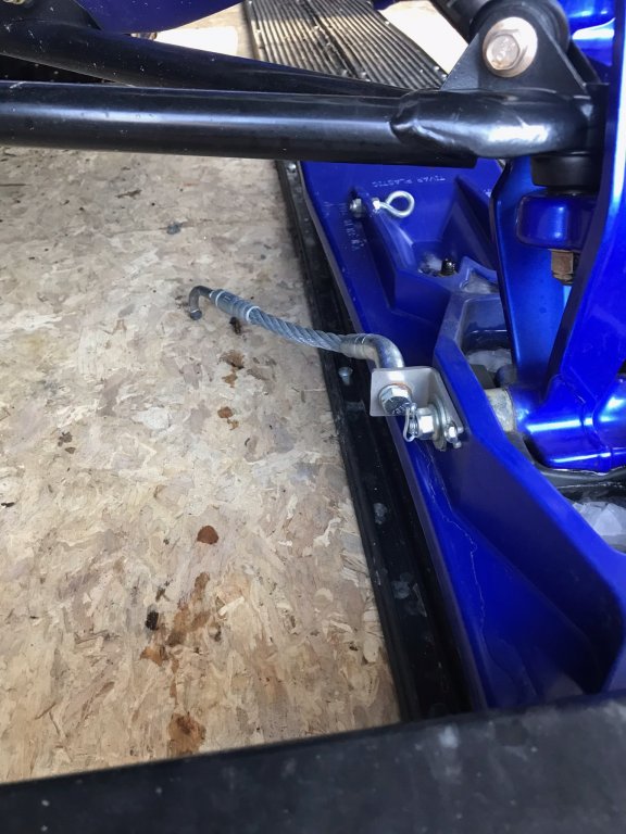

It took me a couple of tries to angle them just right. I think Travis got this design down pat. Because of the mount system, pointing back and not sideways, once you angle the ends correctly they pull themselves back and the angle steers them where they should be with the spray concentrated toward the front of the track.
I used an eye bolt to stow mine on my curves. My stow design eye loop is placed at the very end of the scratcher. Just turn the loop where you want it.
Haven’t had to re-adjust since I put them on last season.
I do not like scratchers but have no choice with a sled that overheats in most conditions. Once they are down they stay down, through gravel, across roads, backing up. Only time they go back up is when loading. They work on ice and hard pack snow. Maybe others have a better working system, that I do not know whereas this is the One and only set that I have ever had to use. All other sleds, I was able to outfit them with rear heat exchangers which is the way to go if you want to do a permanent repair to that problem.

Great pics Motörhead. I have curves also with travis’ brackets and duraflex cables. Do you find they stay put in stow position? I was thinking or ordering the qualipieces ones but really don’t want to give up on duraflex since I already have them and the brackets

When I first got this set, I would just hang them in there kind of where they are at now without anything holding them in the stow position. They would hook themselves onto that inner plastic edge. Look closely at one of those pics and you can see where they use to hit before the eye bolt idea. They held there all by themselves, but I did not trust that they would stay on really rough trails, so I drilled a hole and made a loop out of mechanics wire, which worked really good but looked awful. So now the better looking eye bolt stow.
