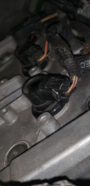

Here is what happens from direct heat from header when running hard.

Tim, your comment got my attention. I've got a nice piece of insulated aluminum blocking that area. I take all the additional heat shielding very serious.
I'll be keeping an eyeball on everything. Especially after I give her a good pounding.

Damn! Crazy
I will have to check mine too!
Any pics of what you did to eliminate this issue ?

Took a piece of old mid pipe heat shield and applied red silicone to it and put over that area attaching to mid pipe heat shield.I will have to check mine too!
Have been watching to see how it holds up.
So far so good.
Still would like a "SR Viper" style heat shield to fit over header.
I really like the design of the air flow under heat shield and out the openings in the top of tunnel to get rid of the hot air.
