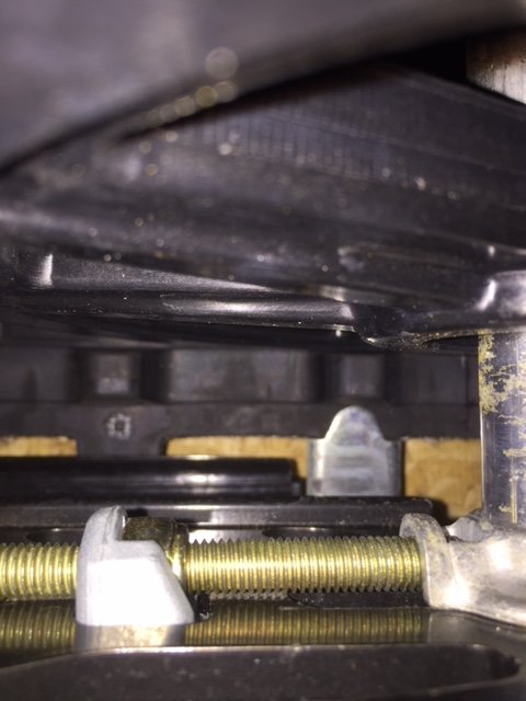

It does show lock nuts in the parts list but there are no lock nuts on my sleds adjuster bolts.

There is locknuts in the adjuster that goes into the rail. See pic. This is why no extra jam nut is needed like in the Old Days.
Hey Joe,
There is locknuts in the adjuster that goes into the rail. See picView attachment 137253
OK Don I see it now. When I think of a lock nut I think of a nut you need to loosen before making an adjustment then tighten after. This is just a nyloc nut that the adjuster bolt goes through right?
Yes just a nylock lock nut.
Once Rear axle is torqued to proper specs There should be no strain on these adjusters. Hell you could take them off if you wanted. These adjusters are there to align and tighten track prior to the axle tightened. they are not there to keep tension on the track. With all the Cat's and Yami's we sell I have only seen one of these adjusters fail.
Something not right or Not tightened Properly from the guy in this post.
