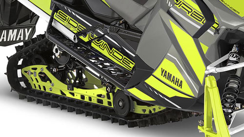

Appears to be. Note this is just a picture off the net but I recall on mine easily enough for a lock nut on the outside.I have not looked closely at mine....is there enough room to just add ANOTHER NUT to the opposite side of the cast piece where locknut sits? It would make things more of pain in #*$&@ when adjusting but if it fit, we could tighten the 2nd nut down to sandwich the cast piece in between the two nuts.

Not sure though, as the bolt is close to rail....see pic below, not sure another nut would fit there.Appears to be. Note this is just a picture off the net but I recall on mine easily enough for a lock nut on the outside.
It looks like not enough room for another nut as rail is too close.
I'm not adding one as I've not had issues. Don't think there is room there. I was thinking on the outside the rail but won't do any good if the existing nut is facing the axle.
