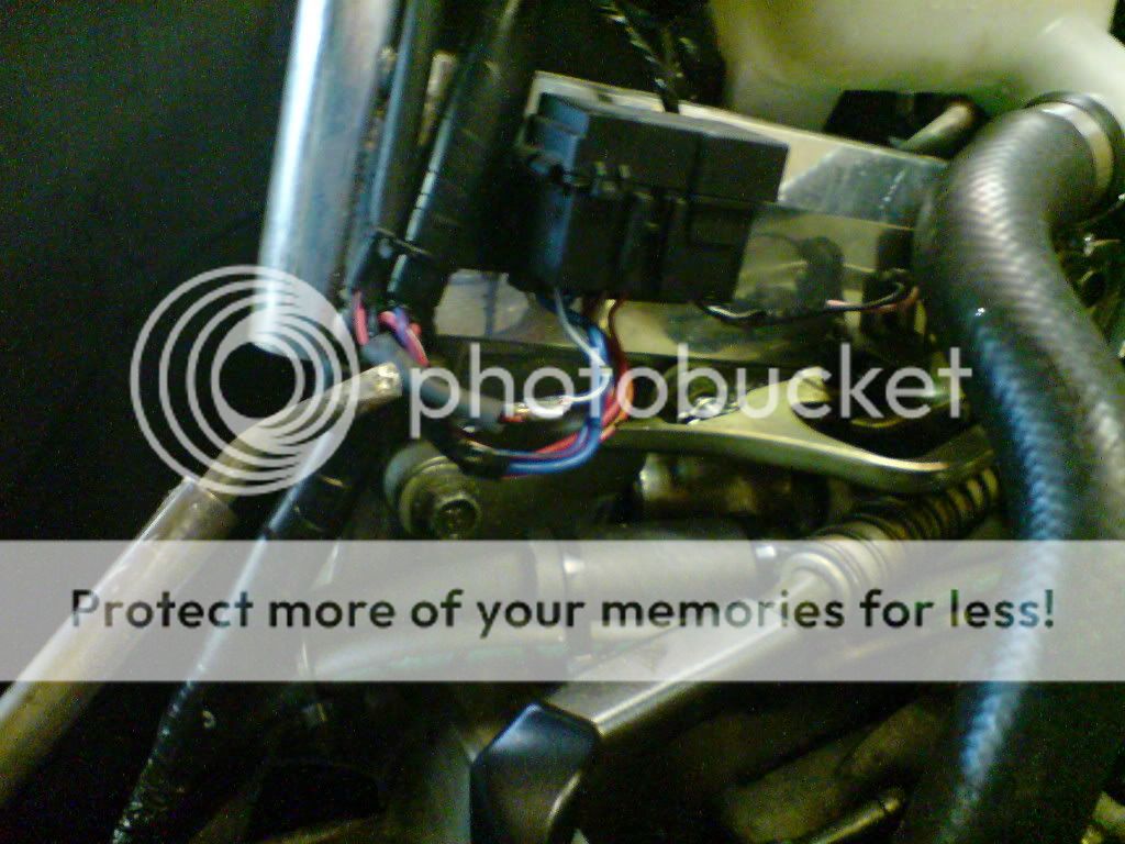

Soldering the AEM wideband postive wire to the blue and white wire under the fusebox. This is where the Bender kit pick up it positive wire to the realay. This wire is only "hot" when engine is running. I am considering adding a water-proof toggle switch to the wideband like Ted J. suggested. So the engine could run for a while before firing up the wideband.

New normally closed type tether install - wired/soldered into brown-white.

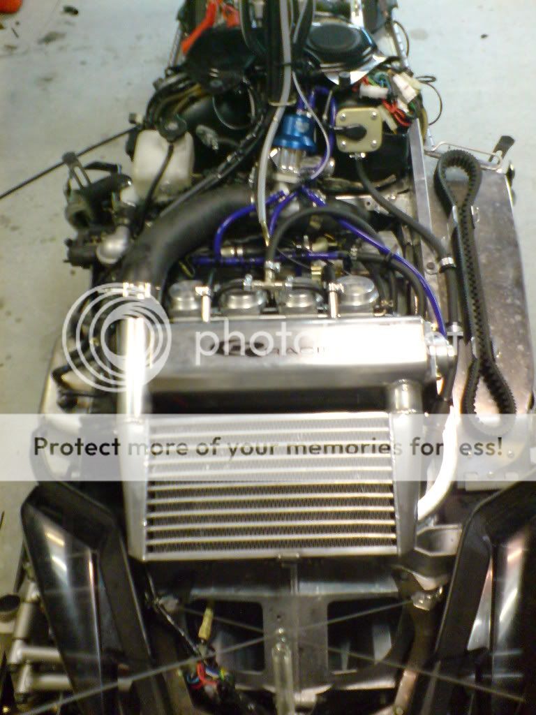

I almost forgot to cover up the hole from the Bender pre-cooler. That would not have been fun during spring time - LOL. I made a aluminium plate - used silicon and rivets to attach it.
I am posting picture of my pressure tester. Because I looked every where for pictures when I was going to install the Bender kit, but never found any.
It is made up from a a silicon hose with same ID as the airfilter, 2 hose clamps, aluminium cap with same ID as airfilter and an air-nippel from a car tire. Easy to make and works perfect.
TT
Well I finally got the sled in the garage at work. Pressure test done - a little leak between the Vortech bov and flange - tighted bolts - all fixed
The picture shows attached homemade pressure-tester to turbo.
