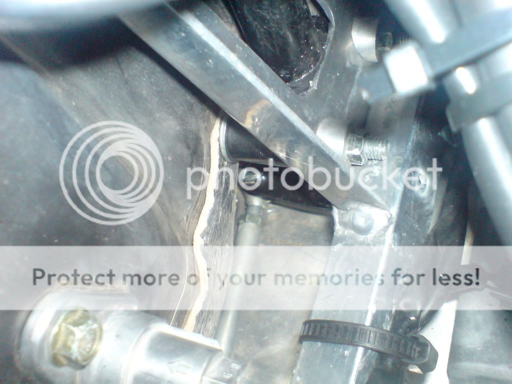

Well I started the tear down (fuel tank and D-frame). As promissed I pulled out the Bender stage 2 IC to give it a try.
It will not fit without any modification. The inlet before the intercoler cord is hitting plastic. It was so bad that I couldn't get the IC in place.
My conclusion is that it can be done, but you would have to have the inlet rewelded
I will try the charge tube also if you want me too. It will need some rerouting after the inlet has been rewelded.Here is the pics of the "try fitment"
Close up pic of the "try fitment" with Bender IC - IC is not in place - it has to go a little more to the left. So you can see that the inlet piping has to be modified.

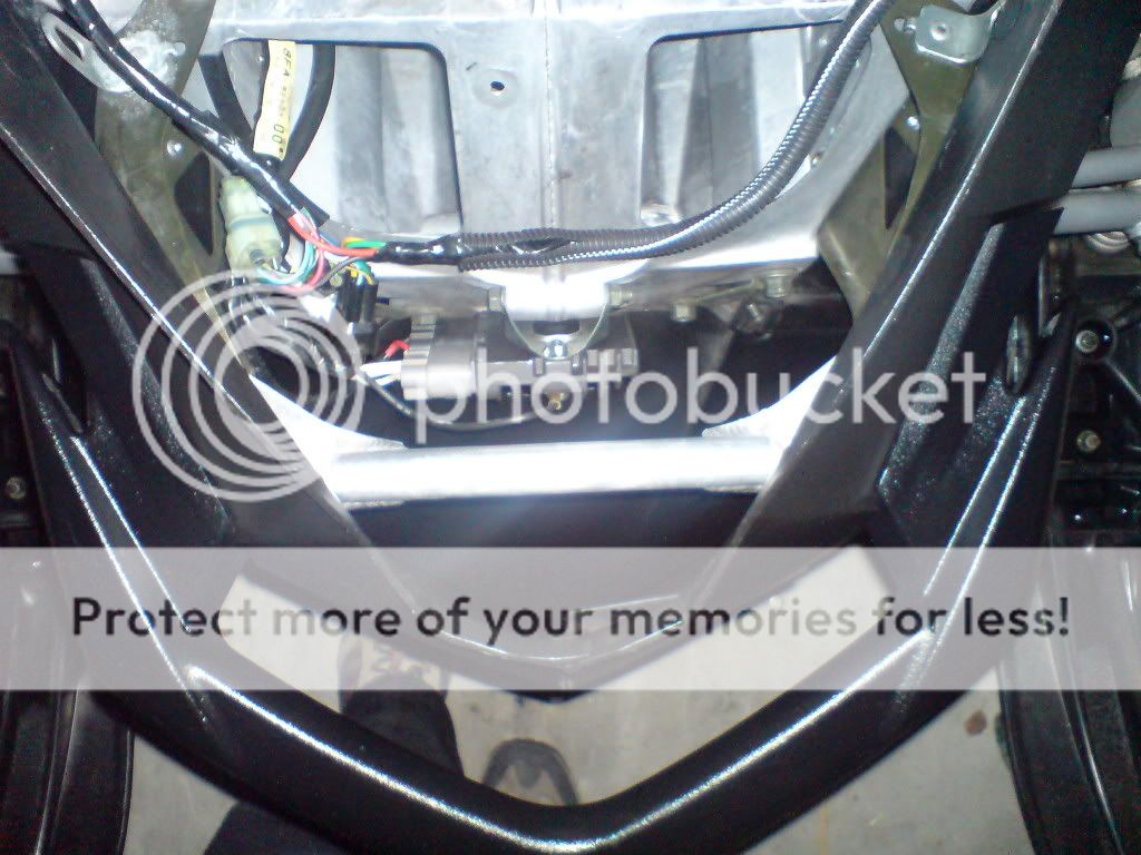

Close up pic in front - fitment is good with the MCX IC
I removed the center/front steel bracket and installed the aluminium one from the apex. It doesn't have to be done - you could reuse the one from the RX-1. If you are doing this mod. with the Bender kit you would have to reused the one from the RX-1 so you are able to secure the IC. Well atleast I lost some weight - LOL
