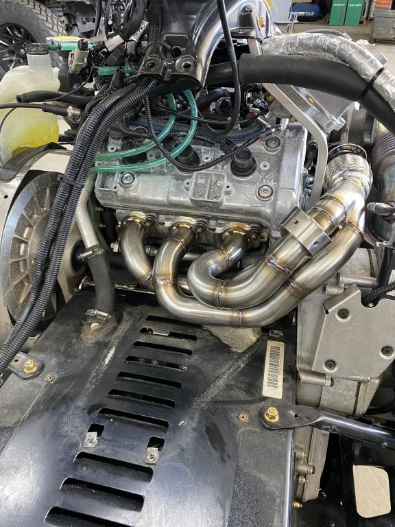

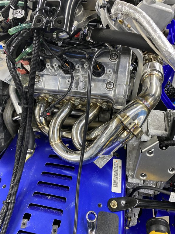

First pic (black tunnel) is the Gen 2 header. You can see the collector is closer to the turbo than the Gen 1 collector. With slight modification, both headers fit comfortably (few mm of space) under the stock heat shields. Top notch stuff from Turbo Dynamics as always!

Now which one is the fast one?
When you say slight modifications do you mean to the lower heat shield?With slight modification, both headers fit comfortably (few mm of space) under the stock heat shields.

Stainless 304 ??? Very nice work..

The Gen 2 Header makes 5 more horsepower than the Gen 1 when hot. It's also more stout/ durable, and imo the fitment is a hair better.Now which one is the fast one?
With over 300+ horsepower, I don't think you'll notice the extra 5hp when riding/racing, but opinions vary. I've had both and I prefer the Gen 2. Just my 5 cents......
Yes just a little trim and massage.
