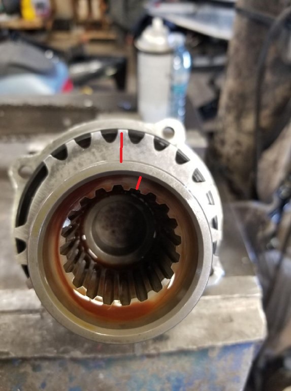

Upton44 is there anyway you could get a picture of the stub shaft so we could see how far the timing marks are off. I know this is happening but I just don't know how this is happening, mine has been doing weird stuff while starting lately I'm gonna have to pull my stub shaft and look at the timing marks i guess.

Dealer is supposed to send me pictures .when he does will post them

That would be great Thanks.
Ignition Timing (Stubshaft) or Valve Timing (Chain)?Well timing jumped.Even though it's off warranty yamaha said they would pick up the tab $632.00

Ignition timingIgnition Timing (Stubshaft) or Valve Timing (Chain)?
Yup thats off one notch. Good catch by a sharp dealer!This is all they sent me .said timing skipped out 1 notch.going there tomorrow will take some more pictures
Should be lined up where red lines are

How does this happen?

Wow that is amazing i can't believe that it can move like that, is that gear just pressed on the stub shaft or what. This looks to me like it could be a problem, all the re flashes in the world are not going to matter if the timing is off. Gonna pull mine apart this week and take a look. Thanks for the pics and info.

We are all in this together.Wow that is amazing i can't believe that it can move like that, is that gear just pressed on the stub shaft or what. This looks to me like it could be a problem, all the re flashes in the world are not going to matter if the timing is off. Gonna pull mine apart this week and take a look. Thanks for the pics and info.
It’s just pressed on. Some must not be tight enough. This is one reason I have been testing the Sidewinder flywheel and stator in my viper motor. It eliminates this bad design.How does this happen?

Any idea how this can happen?Should be lined up where red lines are
Answer above. This is only third time I saw this so not that many. Quality or lack of it plain and simple.Any idea how this can happen?

Dont see how it can jump like this without damaging those splinesShould be lined up where red lines are
