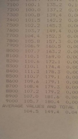

For what its worth here is the Dyno print out from my 2016 Yamaha LTX SE with Dealer installed MPI about 2 weeks ago. The great news was I read on TY that the controller might be bad, and told my dealer prior to dyno. I had dealer also install AFR and Boost gauge. They verified very quickly when you boost jumped to 8 lbs. and shut down quickly. My EBAC had to be disconnected (dealer called MPI directly).
As I understand it...and believe me I'm new to this boost game, with no EBAC there wont be any boost compensation for altitude. We were at 900 ft elevation (if I recall). The first dyno pull was 171 HP with boost showing just above 4 lbs (manual gauge). Adjusted wastegate (maybe 1 turn don't quote me....I know it was adjusted at least one turn total) and 2nd pull was 175 I believe. Re adjusted boost to ~5 lbs (not over) we saw 181 HP.

AFR numbers were 11.5 - 11.7 if I remember correctly

BTW watching your own sled on a dyno is somewhat intimidating.....but I can check that off the bucket list! Framed the Printout and it hangs in my man cave !

Welcome to turbo land! I will guarantee you will want more..... But Captain I've givin ya all she's got!
I can tell ya 9#'s and no ETEC on the planet can catch you. Now I am trying 20#'s to see how many times I can lap them
