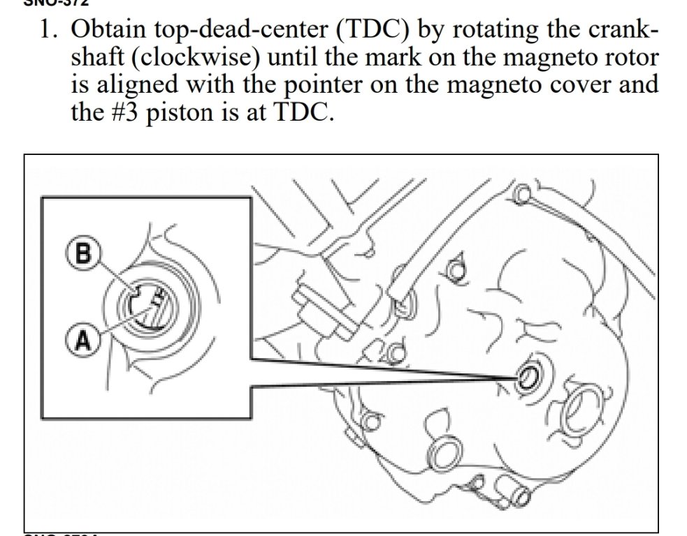

How do you tell TDC? I see 2 sets of marks on flywheel. Which one is TDC on #3. Trying to remove water pump.
no1b4me
Just turn the engine clockwise on the MAG side and line up the indicator mark.... Just pop out the larger plug in the MAG cover.... Clockwise only on this side.... Sounds like you could be 180 degrees out

I’m lined up. There are 2 marks horizontal across flywheel connected by a line running horizontal. Then one more mark. After those. I’ve tried lining up with all three and no luck.
