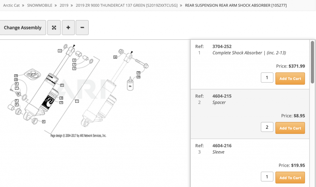

If you want to save some cash, you could go with the REAR shock from a Tcat which is still a nice Qs3 but without rebound which many don't ever adjust. No Kashima either.
A VERY good shock for nearly half the cost.

That's what I'm going with all around from a 19 t-cat. Got the DSC valves from my turbo viper and the valving I ended up with . Can do the three shocks for roughly $1600 CND from cat.

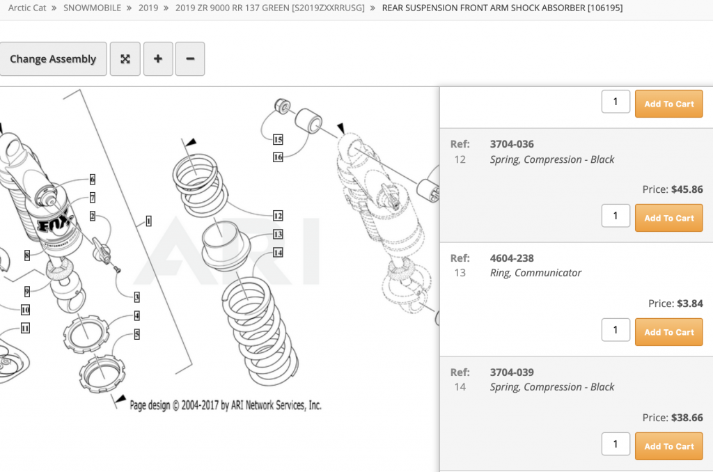

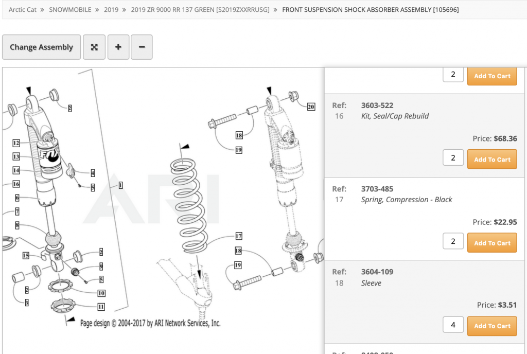

And here are the coil prices for same sled....
looks like front coils are black in color.(#17)
Center shock needs two coils(tender setup) and coupler. (#12,13,14)
Dan
I would seriously reconsider using the Tender spring and crossover (communicator)set on the center shock. Many have had the crossover wear into the shock tube. I suspect by this year many will find the wear to be very bad already.
