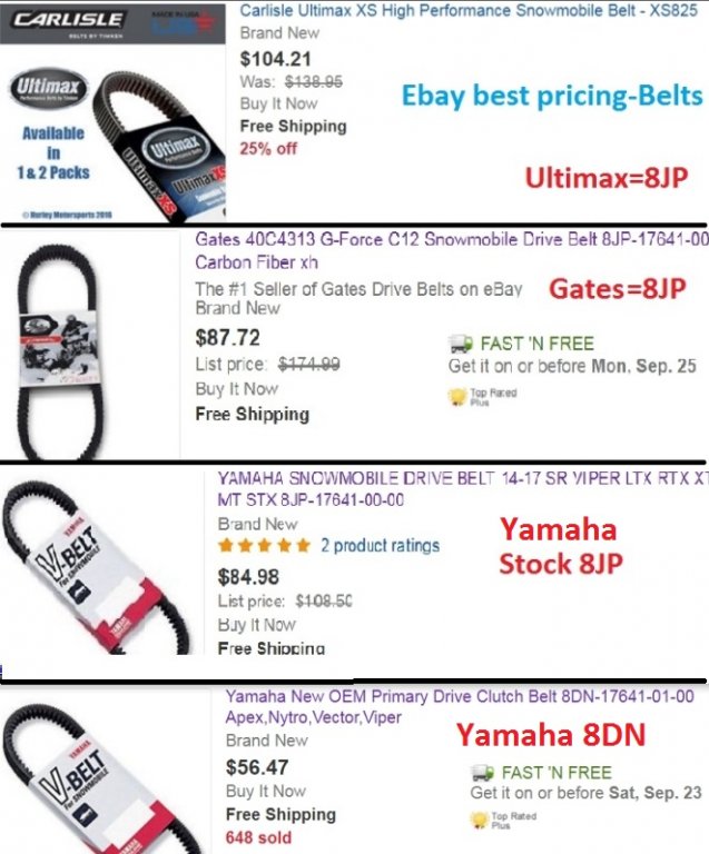

The Gates Carbon cord is a very nice belt that performs well. About same cost as 8JP.
the 8DN is far cheaper then all, so maybe for trail miles its smart, and you can use a dial-adjust to raise the belt above secondary like the doos, for proper deflection (will still be 3mph slow on top only)
Heard the Ultimax last longest by a few guys, costs more too.
Image below is ebay best prices w/free ship and no tax(for most)

Thanks Dan,nice job aligning these up,for us.Just tell your dealer the first 3 digits, they should know rest. 8DN or 8JP.
Dan

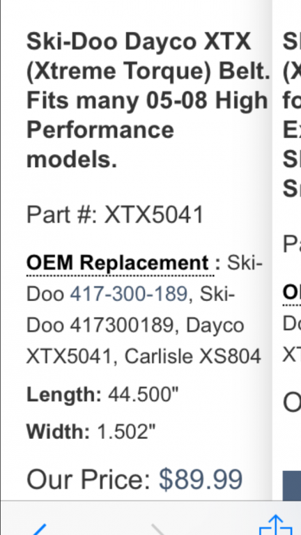

I wish the almighty doo 391 would fit....its quite tough.Anyone ever try other belts like Ski Doo, or arctic cat i've been noticing on some cross reference their belts very similar to ours in length and width
