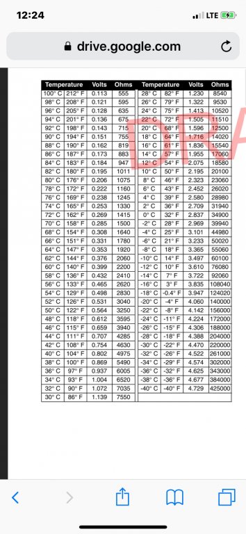

Your sled also has a barometric pressure sensor, if this sensor isn’t working correctly fueling issues your having could be related.
I tried to find some method of testing but got nothing from the manual.
If you get good readings on the air temp sensor I would suspect the baro sensor.

An inaccuracy in either the temp sensor or the baro sensor will cause similar issues.
Pic of air temp sensor location.

Your air temp sensor has a negative temperature coefficient, meaning as temperature increases the resistance goes down. Most fail open, if this were to happen your sled would run rich, yours is lean. This leads me to believe it will check out OK, but check it anyway.
Another Phase
That's great, thanks. I'll check that this weekend. Much appreciated.
You mentioned you had one plug discolored, it could be just a stuck injector. Was the plug black or white?

Will do.Your air temp sensor has a negative temperature coefficient, meaning as temperature increases the resistance goes down. Most fail open, if this were to happen your sled would run rich, yours is lean. This leads me to believe it will check out OK, but check it anyway.
Another Phase
Plug was white.You mentioned you had one plug discolored, it could be just a stuck injector. Was the plug black or white?

The other plugs tan?Plug was white.

Did you take pics of the plugs?

If one plug is white and the other two are tan you’ve probably got a dirty/bad injector.
Be nice to see a pic

The other two were darker. I wouldn't say tan, they were darker, but had also endured a 50 mile run back to the trailer at a blistering 30 mph. Sorry, no pics.If one plug is white and the other two are tan you’ve probably got a dirty/bad injector.
