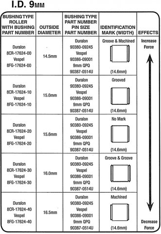

Has anybody checked what rollers are in this model sled? I mean they should be the same....but......
Same 15.6mm rollers as the other SR Viper 129, 137, and 141 models.
Yeah I saw in the parts fiche it said that, glad somebody actually checked to see it was correct.
