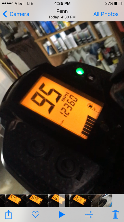

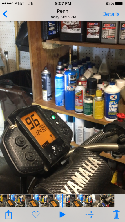

Stock helix stock clutching:
96mph @ 12,430 A1
96mph @ 12,420 B1
Schmidt billet helix stock clutch
95mph @ 12,370 A1
95mph @ 12,360 B1
These are on a stand. No load. Not enough snow to test ride tonight. Swapped to another stock secondary spring. No change..
96mph @ 12,430 A1
96mph @ 12,420 B1
95mph @ 12,370 A1
95mph @ 12,360 B1
