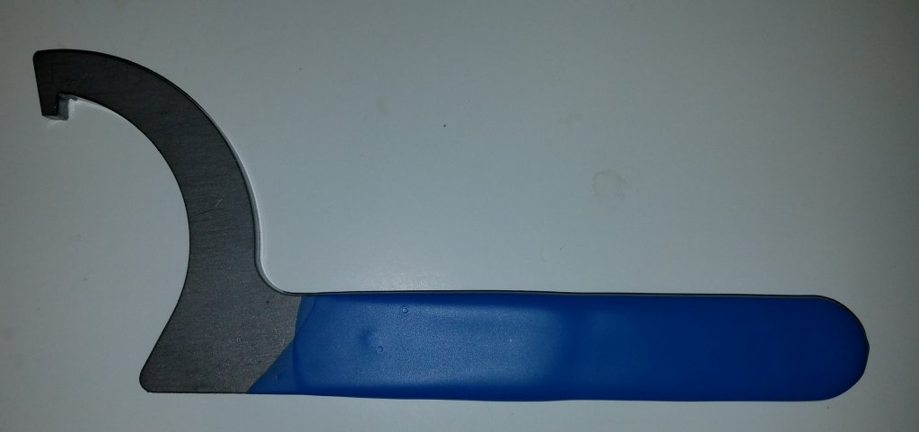

If anyone is sick of busting knuckles when adjusting center shock preload with the crappy spanner wrench that comes with your sled, I found a nice upgrade... thicker material so it doesnt slip off the nut, and the angle let's you work in a confined space better than stock.View attachment 150305
I'm just getting ready to Plasti-dip the handle to make it even better.... And blue. ;-)
View attachment 150306 there, that's better.
Source is:
UTV /Offroad 2.0", 2.5",& 3.0" Shock Dual-Rate Hardware Spanner Wrenches | Schmidty Racing
https://www.schmidtyracing.com/Dual-Rate-Hardware-Spanner-Wrenches-p/st-sr-drsw.htm
The wrench you want is the Fox 1.5 preload wrench, about $18.
It was an easy sale since I need it for center spring AND my new Fox H1 - 1.5 Zero Pro Rear Shock from Hygear.
