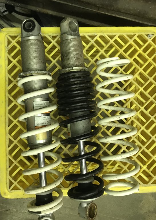

I personally would just get the shock rebuilt, u would have better chance of getting a better job on the shock than a new one . Just a heads up there is zero grease on shock pivot points from factory. The center black spring off a old 99 sxr 700 center shock , almost looks the same rate springs as the sidewinder lol . Will be testing these soon .

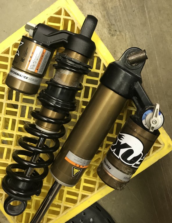

I was a little disappointed my rear shock still had good pressure in it 185-190 (best I could tell) . I was hoping for a improvement by just a rebuild, looks like have to reshim a little stiffer

Center shock rebuilt nitrogen was around 165 , stiffen up shim stack and put on straight rate spring . Should be a lot less for turning effort with this and snow trackers , will test next weekend . Hope it’s somewhere close to my apex ... lol
All the shocks take 200psi Nitrogen.
Yes I know I was just checking for a ruff pressure that was in them before rebuilding . rear was about 190 centre shock was down to 165 . I have stiffened both compression stacks now . Had to wait on Rear shock didn't have the half inch centre hole shims I wanted. But just finished last night ready to test this weekend. I was really beating up the rubber stops on the rails
