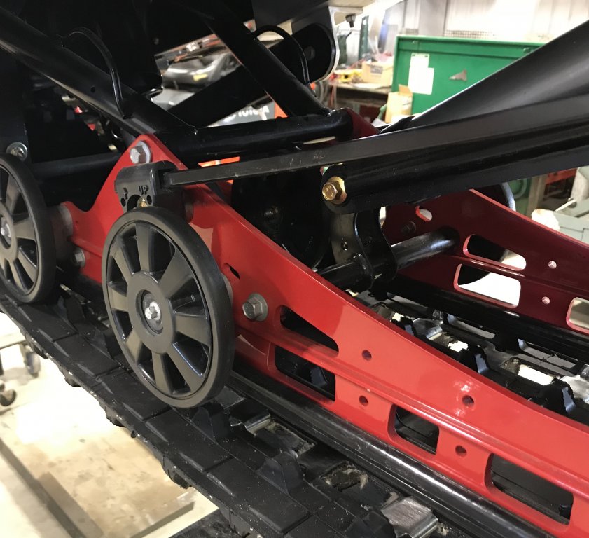

This might have been covered by someone else . If you taking your suspension out or putting in, take out the front scissor stops at the rear of rails , makes it easy to put in. Just make sure u put the stops back in!
