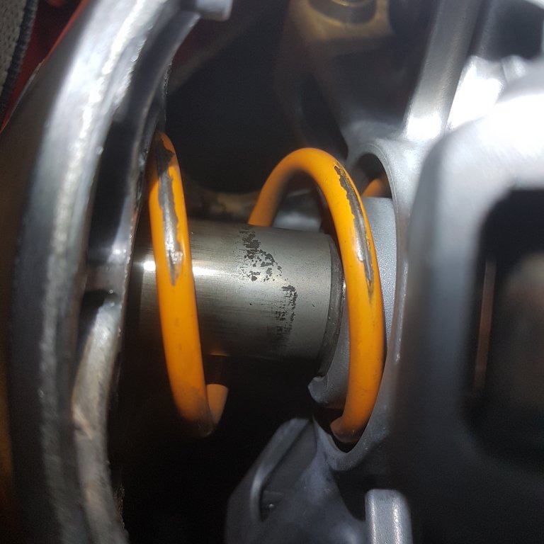

Did you ever try the 8dn belt?Not sure what is going on with my clutches either. I installed the Thunder Products Orange Secondary spring which I believe is made by Dalton. My clutches are now super hot and the belt itself is hot. I can't keep my hands on it. Not sure what is the culprit but I am leaning towards the Secondary spring. I have it wrapped 3/3, I had a hard time to rotate it enough to install. Very Stiff. I may go back to the original spring and check the temperature. I run the Gates Carbon 8JP and it is making a lot of dust and I can smell it. I ran this same belt in my Viper with very little temperature or dust. My Sidewinder is not flashed either.

I did not. I have only tried the Gates 8JP so far. Its funny because NOSPRO released an update yesterday about the Orange Secondary spring. They were originally suggesting the Orange spring to be set at 3-3. When I installed the it at 3-3 it was very tight. I made a run with it at that and it wasn't working right. Very hot and burning belt rubber like crazy.Did you ever try the 8dn belt?
I took secondary apart and found the belt was only making about half travel down the sheave. I had made a line with a marker. It would appear the spring was too tight and holding back the Secondary from opening. I have no idea how the belt didn't blow.
I reset the spring at 2-3 and made a run yesterday. It worked very well. Temperature was reduced significantly, RPM'S were 8700 a little low. The only thing I noticed was the RPM'S never spiked? From my experience whenever you hit it, it is normal for RPM's to spike and then settle back, no? I tried a few times to check this but I only get linear acceleration. RPM's are a little low but I will fix that.

I guarantee it was slipping the Gates Belt. I had to clean up the dust. The excessive torsional force of the tight spring was not allowing the Secondary to open. The Primary was trying to ride up but the Secondary spring wouldn't allow the belt to ride down. Slip will have to occur. I also had a black streak on the Secondary mid way down.Well that doesn’t make a lot of sense? Your RPMs went up and you reduced your spring wrap? Are you sure you didn’t make any other changes? Reducing wrap usually reduces belt clamping force which in turn causes more slipping. But like I said before you were clamping that soft belt to hard, pretty positive with your setup it wasn’t slipping that Gates.
