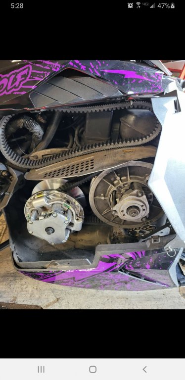

You could use the Yamaha Secondary but like yamamarc indicated not without modifications. I am pretty sure KnappAttack experimented with a Team Primary and wide belt off a Tcat and a Yamaha secondary with mods a few years back.
This guy has a xs 825 belt on it.

It doesn't look like you can adjust the primary to the smaller belt width on that primary?This guy has a xs 825 belt on it.
To make it work they must have disassembled the primary and machined the spider ect for narrower belt?
Maybe he is just running the primary with the excessive belt side clearance?It doesn't look like you can adjust the primary to the smaller belt width on that primary?

Must be!!Maybe he is just running the primary with the excessive belt side clearance?

I dont know how he is using the narrower belt.
