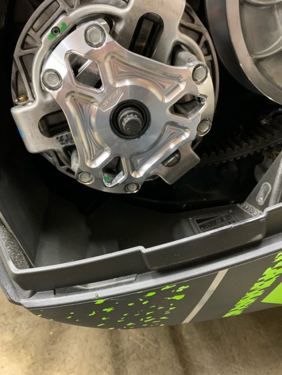

I just installed the Bikeman cover to replace the cover I broke last winter. I thought I'd give it a try as they say it reduces clutch temps 40-50 degrees. I don't necessarily believe much of what I read on there, but figured it was worth a shot!
Nice looking cover! Anxious to see if these new covers eliminate the issues some where having with stock cover.
