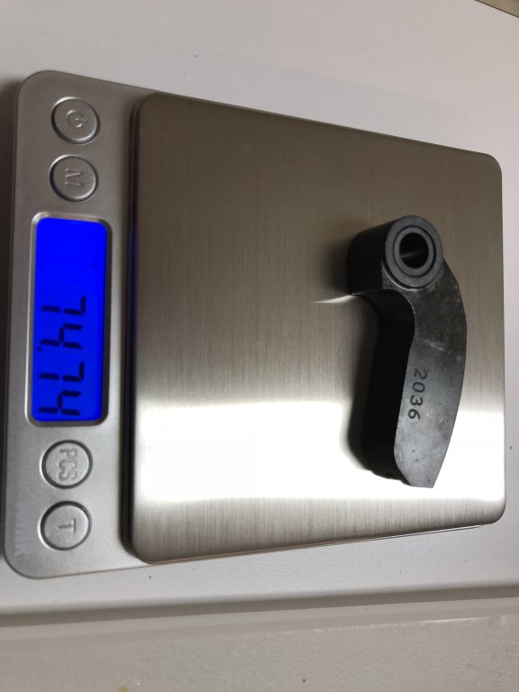

Snobeast. I am running stock muffler tunes. Eco, PT, and Max Spool 16. I have the Turbosmart BOV and.3 bar sensor and stock air intake. I have TDs clutch springs and Dalton weights but stock helix.
My DTYA-1s are 74.74g empty.

Are you sure the weights empty are not 73.6 daltons site states they are 73.6 to 81 loaded up,have you any way of checking your max pressure once WO to see how high it goes? I understand now with his tune you can check it on one of our gauges,and it states what is in real pressure. I have a pressure gauge set up on my muffler,but it always seems to read high,i do understand a modified muffler will build more boost,as mine is MSM now,last year I ran a Dalton 3" but with this tune now,it would overboost and may give me more lights,and retard timing,so I sold it,and had woody do me up a msm and the td max 16 tune,with bov and 3 bar sensor.Snobeast. I am running stock muffler tunes. Eco, PT, and Max Spool 16. I have the Turbosmart BOV and.3 bar sensor and stock air intake. I have TDs clutch springs and Dalton weights but stock helix.

I think so. I took this picture to remember it.
The Max16, BOV and 3 bar sensor are new this year. Zero miles yet. For whatever reason my flasher and tunes last year did not have the data-logging active. I won’t be able to report until I get to ride this year.
ÉDIT IDK Pete I’m going check my weights tomorrow. I have a note I wrote from last year stating 73.9g.

Were those ramps completely empty,once up to camp I will have to reweigh my dtya-1 ramps empty,i have same scales as yours,how did it run last year,on PT with that set up,did you run Dalton secondary spring org/blk at 70 degrees with your stock helix? At what rpms did it run best at?View attachment 143642
ÉDIT IDK Pete I’m going check my weights tomorrow. I have a note I wrong from last year stating 73.9g.

My recollection is I left them empty as advised as a starting point and took that picture for reference.
Stock helix. TD clutch kit (Dalton black teal primary, black orange secondary set to 60). My rpms were low ~8600.

My weights are def empty. What they weigh I'm not gonna swear on until i put them on the scale again. Hoping this years mods get me to 9000 rpms on Max 16.
