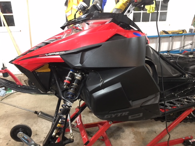

You could install a snorkel for your intake air. Your intake temps will me much lower, with turbo you will notice an improvement in performance. I chose to install carbon fiber venting on a second set of side panels.Thanks. Went out this morning 30f running at 40mph and cooling temp 195f no fan on and intake temp still 76f. How much power are we losing because of using warm combustion air. A turbo uses an inter cooler for this to make more HP. Anyone have a remedy for this so we can have intake temp the same as outside temp.
