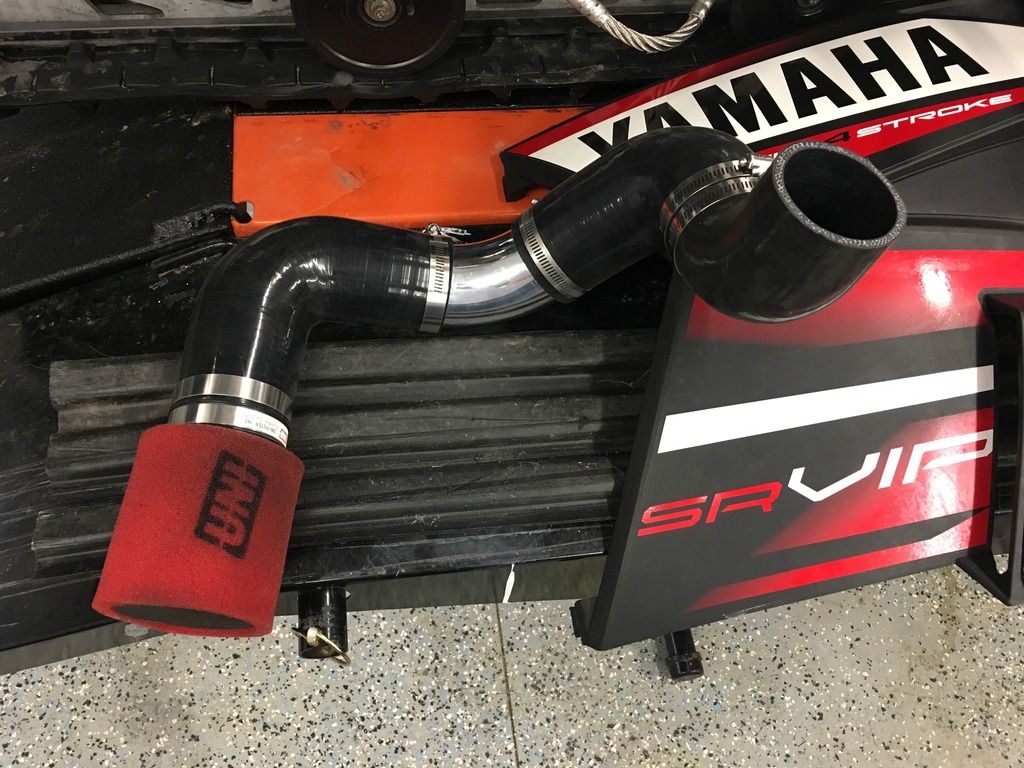

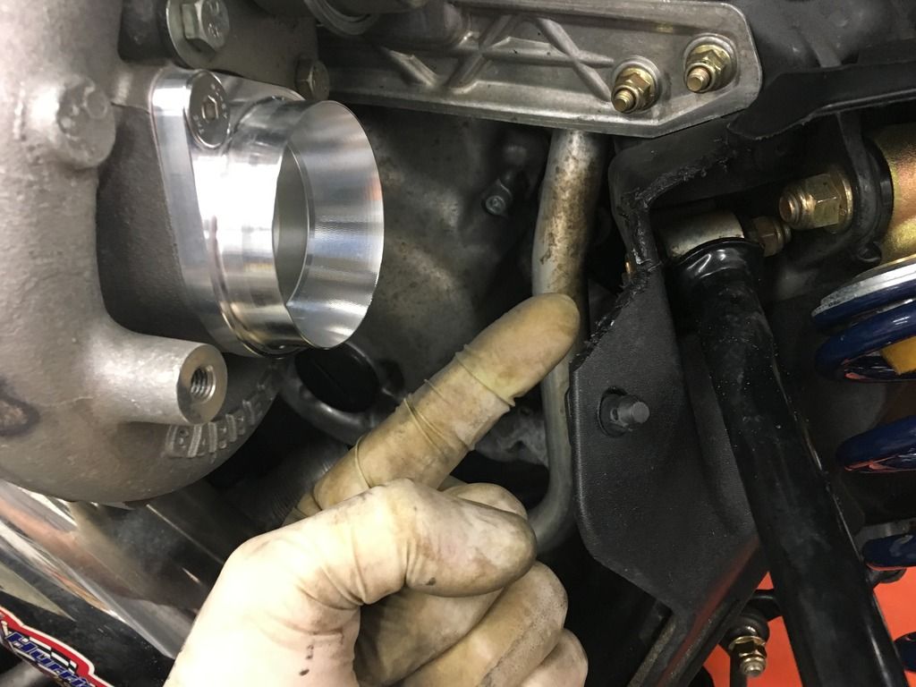

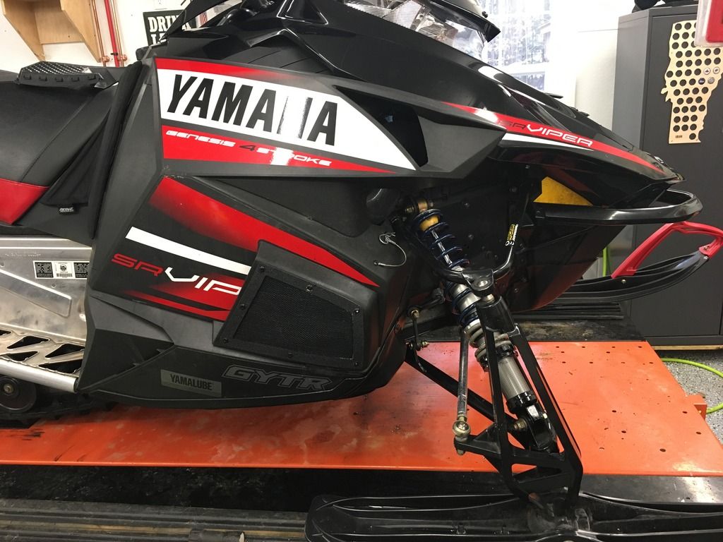

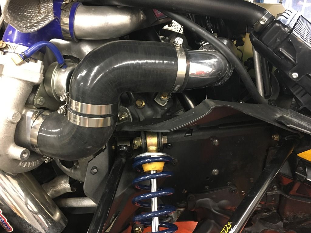

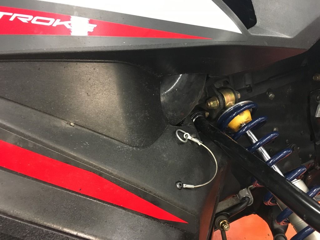

I rode this week in some warmer temps. My intake air was anywhere from 98 to 125 degrees. I called Hurricane and told what I wanted to do and he sent me some parts to make my own. I plumbed to so the air filter is directly behind the frog skin in the nose area. I did have to cut my side panel.

Looks good stain. Keep an eye on your air fuel gauge. I plumed my intake to the outside and I noticed I was running lean @ wot

Tested my set up yesterday. I dropped 25-35 degrees on intake temp. 1 bonus was the noise I was hearing from 25-35 mph and assumed was the Hindle exhaust seems much quieter. It must have been intake resonance. I even took my earplugs out and didn't use them the rest of the day.
