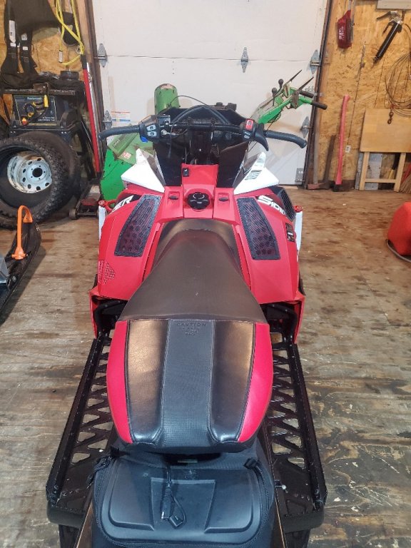

This is the best picture I have of the venting.

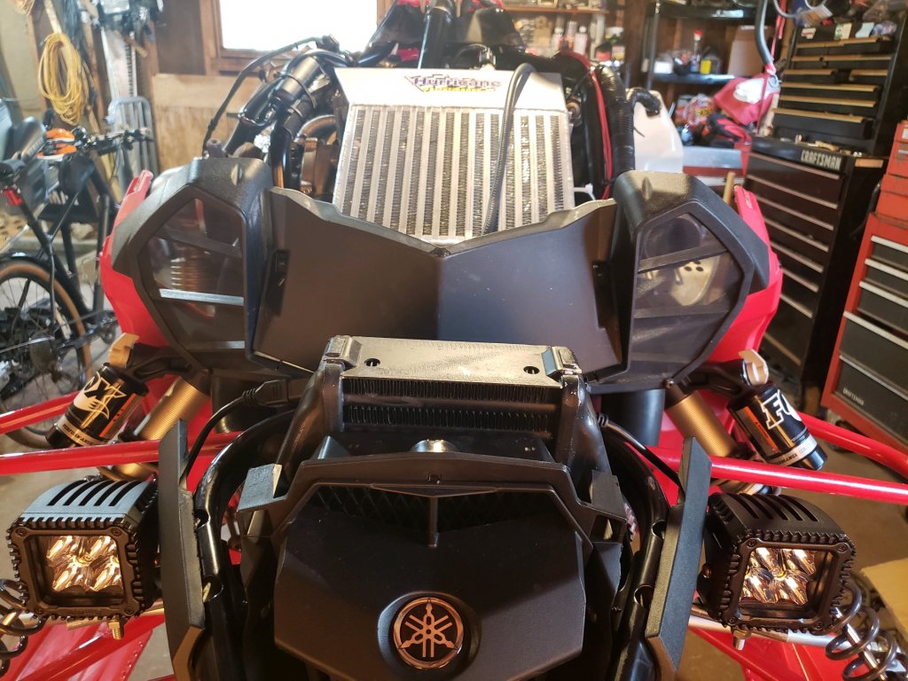

Would you by any chance have the part # for the frog skin you used to cover up the holes?The plastic area between the factory frog skin vents i opened up and installed frog skin material to allow more air flow thru the secondary intercooler. Brings in huge amounts of cooler air under the hood.
I didnt take a picture with the screen installed.
View attachment 166644View attachment 166645
