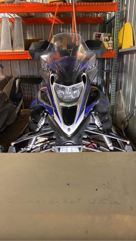

Hey guys so last season I had a non stop over heating on a day trip, the snow was dusty so it kept slushing up infront of the heat exchanger and it would cause it to over heat. I know these sleds have air flow problems so i removed the hood and strapped it to my backpack and that solved the over heating issue. I already installed the gauge console vent and that seem to help abit. Is there a way to move the radiator to help flow?

This is where I was thinking about adding 3" frogzskin vents to let the hot air out.
I added ice scratchers to it but it just helped ice everything up.
