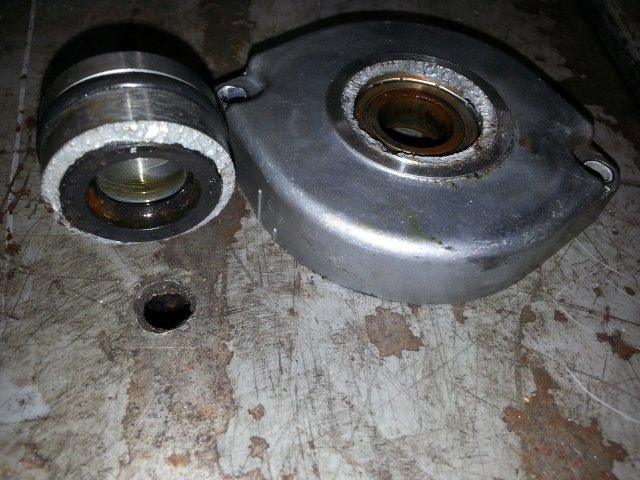

Here's some pictures of whats left of the old starter and parts.
Broken magnets!! I believe this is where it all started. After the magnets broke the stater still worked and it always started but it sounded weak, kind of like starting with weak battery but the battery was fine. I started getting lots of kick backs about 3-4 weeks ago and prior to that never had one.
Nose cone broke of the starter

Hard to say what went first. In this case I am guessing the nose broke first. Is intermediate gear good yet?
