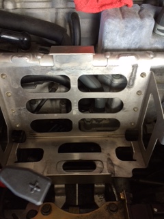

My battery box looks welded to the frame. Thus, I don't see how you can remove it. It is silver and also has rivets going down the side. Any suggestions?

Then someone has modified it... can you post a picture? That battery rack has to come out or you will not be able to remove the filter.My battery box looks welded to the frame. Thus, I don't see how you can remove it. It is silver and also has rivets going down the side. Any suggestions?

Welded in battery box?

you have to take out the whole thing cross pipe and all there is a bolt on each side and then you have to twist and turn it to get it out past all the wires and such also two smaller bolts in the front bottom need to come out too it is a big piece.

No follow the support tubes to each side, unbolt it, then also unbolt it from the steering rack on the bottom.

I can't thank you enough. Yes, I see the bolts tucked away under cables.No follow the support tubes to each side, unbolt it, then also unbolt it from the steering rack on the bottom.

I do also believe you will have to give that battery box bracket a twist to wiggle it out.....

Ya bit of a pain but not that hard to do. I like the guy who modified the battery box so you don't have to take that cross piece out. Search not working but he should start building them. People would buy them in a heartbeat!
