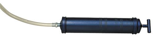

I just sucked out all my oil from my tank (Yamcharger has the tank relocated and I didn't use their drain hose system) and I also changed my filter and drained my engine drain.
I put 3 liters of oil into the tank, it's nearly full. I am sure this is nothing unusual, as I've changed my oil numerous times over the years and it's just a matter of not remembering from year to year that this happens!
I cranked over my engine a few times (sled is all apart) and the oil level went down a bit. So I am sure that once it starts up it'll drop down!
