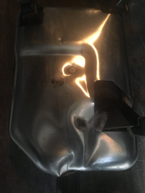

In 2017 my sled backfired so loud it blew it wide open and had to get it replaced in Quebec on a trip.This year went on a trip to Quebec after Christmas and it backfired 3x at -30 but never blew apart.
Just completed a 2k saddlebag trip and when I got home I pulled the muffler because it didn’t sound right.
Well quests what!!!!!!!
Guys pull your mufflers and inspect.
Wow!View attachment 138015 View attachment 138016 In 2017 my sled backfired so loud it blew it wide open and had to get it replaced in Quebec on a trip.

Backfire while riding or attempting to start, just to clarify? Mine, with the 17' update mapping, likes to "pop" on failed starting attempts below -15*f. I've never experienced one while riding, not even little lean pops during deceleration like my Phazer gets once in awhile. Not sure my Can has enough back pressure to blow like the stock suitcase would.

Severe cold backfire on startup only,
Runs flawlessly otherwise.
It all started once my sled was flashed with latest software.
It never started like a 4 stroke should when new in cold weather but never had this SHOT GUN BLAST.
Btw that pick is showing the back side of muffler, the front side is not damaged so that’s why I said pull your mufflers and inspect if your sled backfired on startup.

My sled had had some awful loud backfires on starting and I heard my buddies XTX just blew the back right out of his muffler.

Yea... I came back 3 days early from my trip because my riding partner got sick.
If I kept riding, it would of blew the coolant hose or melted the mag cover cap off and I would have expelled my oil in the motor.
AND YAMAHA DOES NOTHING!!!!!
I assume this is with new flash?Yea... I came back 3 days early from my trip because my riding partner got sick.

Yes sir... latest flash and the Yamaha rep at my dealer said my original mapping was not available to be reinstalled.
You have to understand....
I’m a Senior master technician with Subaru with 22 yrs of experience and this fuel mapping is unacceptable.I know more than the average owner and I on a weekly basis deal with drivability issues that I work with field service engineers changing mapping to FIX THE PROBLEM FOR THE CUSTOMER.
We should not have to spend all this money in the aftermarket world to get these sleds to preform in SNOWMOBILE CONDITIONS.
More owners should be PISSED about this and letting Yamaha know about it.
Nothing personal, love this forum and all of the members helping each other and that’s why I’m a LIFETIME MEMBER.
