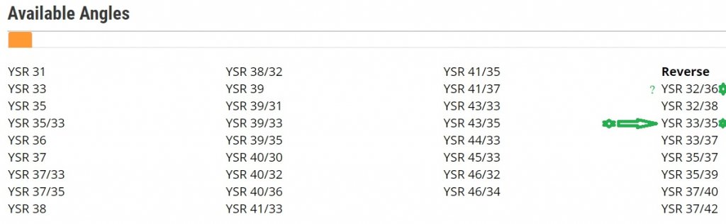

Dale does have a nice selection of Helix...I normally buy from him when Im up north, but here at home I try to buy USA just more cost effective.Right.. Dales secondary is soon... has choices in primaries and helixes right now...
Dale has a 32/36 which Id LOVE to try....
Daltons helix below:

Im anxious for sure, since mine is a 129 and will be different then all the time I spent on Toms 137 last winter.Dan Do you think the 32 will help cure the missing fun factor down low ?
I see you got the 129 , which has better transfer .
Are the torsion springs the same on the 129 and 137 ?
I cant wait to see how it transfers, and moreso Im super anxious to see how that "delay" is on a 100% stocker. I have had my suspicion that the larger outlet and muffler(2.5") has had a negative affect on initial throttle hit. Last season I never was able to ride any other SW back to back with Toms, so I was never able to actually compare to a stocker. So right off the bat, I should learn if that delay is an anomaly with Toms setup, or if it was brought on with the muffler setup. Either way it will give me a ton of info as to what direction I want to take my own sled.
Clutching will only help the stock setup so much, but that 'delay' IMO is purely a turbo spool thing. Ive talked to Allen, Ben, and several other long time Turbo gurus and ALL seem to agree that is what causes it. And I just want to see if it is exacerbated by the larger muffler.
I would like to try that 32/36 from Dalton but I am starting with the 33/35 from Lonn as Shag and Terry have worked with it along with the orange.
What guys need to understand about where I ride is, my setup will likely be alot different then many here...the very tight trails and knolls/elevation changes is why that delay drives me nuts, the etec and 4tec work well with instant throttle response, so that is key for me. I want to have a long convo with Dave about his low rpm spool flash, and see his thoughts. That could be the ticket for my area.
