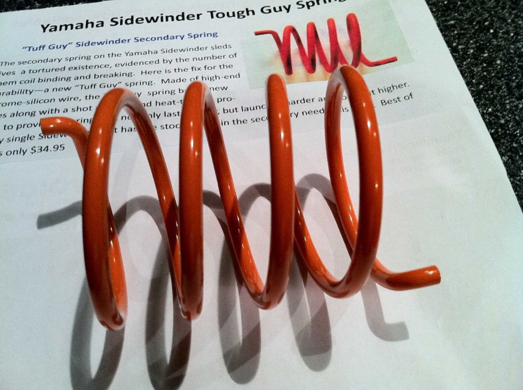

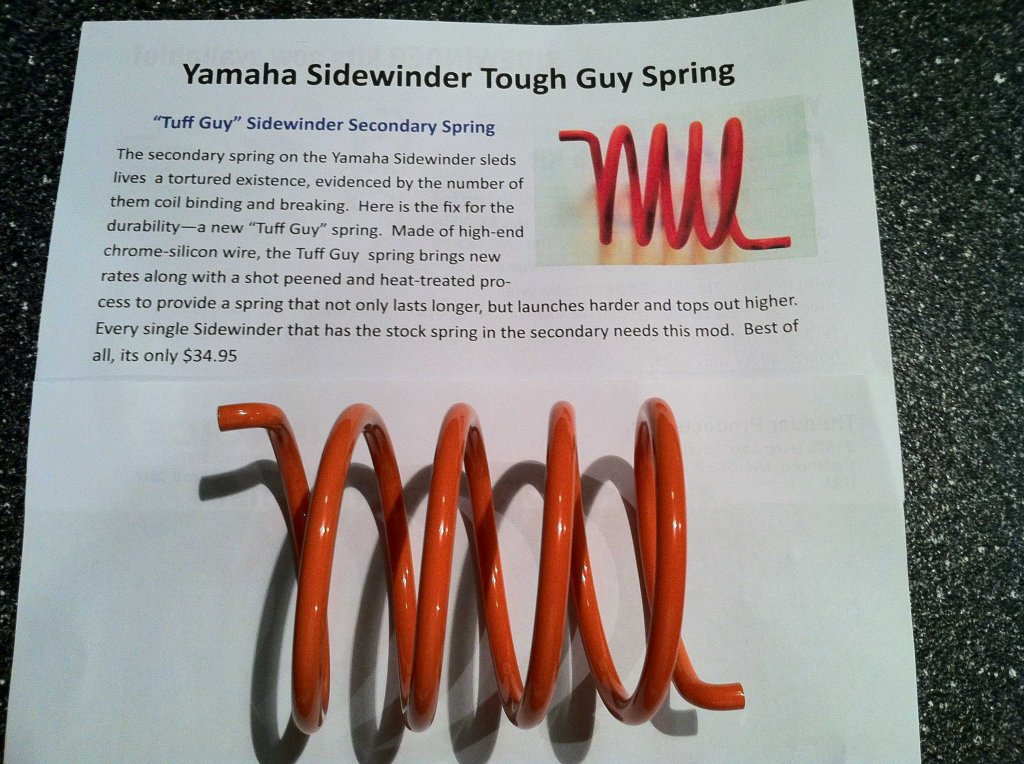

Lonn got this out to me fast.....Nice looking spring!

Mines a coming too!Lonn got this out to me fast.....Nice looking spring!
