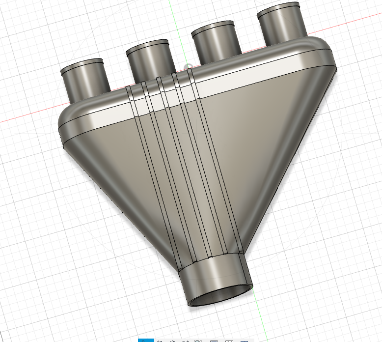

The bellmouths will be better than flat mounted to the base of the flange. The bellmouth will catch the air as it bounces off the back wall, for lack of better terms. You need volume to help reduce air speed and dissipate heat. A small volume high speed intake will run higher intake temps and less horsepower per lb of boost.
Here is my plenum redesign.
Due to the fact the apex TB rack doesn't sit centered in the frame, Ive had to offset the inlet to the plenum as can be seen here.
(Will add more reinforcement ribs once the final size is determined.)
Will this adversely affect uniform flow to each cyl?
Boost hides some of the asymmetry but your primary airflow is going to be better for the closer cylinders. (shorter from intake to output). The question is how much. Under boost it probably is minimized.
If you are concerned what you can do is offset the angle slightly of the input tube so it is more biased (canted) towards the farthest tube, the other thing I have seen done is to put a hump inside the plenum in front of the shortest run to make the air flow around the hump which makes the lengths more equal, equalizing the flows between the shortest and longest runs. Its hard to make improvements however without CFD modeling or trial and error.
If you want to give yourself more confidence, print out the manifold and use a blower motor to simulate the turbo and measure the outputs.
Also, what others have done.

I think you're fine on that asymmetry. I look at a lot of car stuff and never seen that to be a huge issue for anyone trying to make 10lbs of crap fit in tight spaces. It is pressurized air so it will go EVERYWHERE.
I tried to angle the outlet but i dont think that will help much.. Probably good enough for version 1.

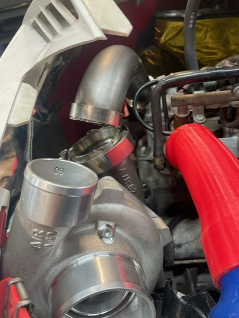

Some updates... getting there. header primaries half done, thanks to @kennyspec. I couldnt get 1.75 elbows so i went with 1.5. The difference to 1.75 dia is the wall thickness of .065. It looks like the alpine header i had on there was also 1.5. It should spool up quick.
flowmaster 1-2 for dual exhaust. will be angled down and cut once in the final position.

What's the reasoning for all the mufflers? Looks like a headache for the fabricator........
