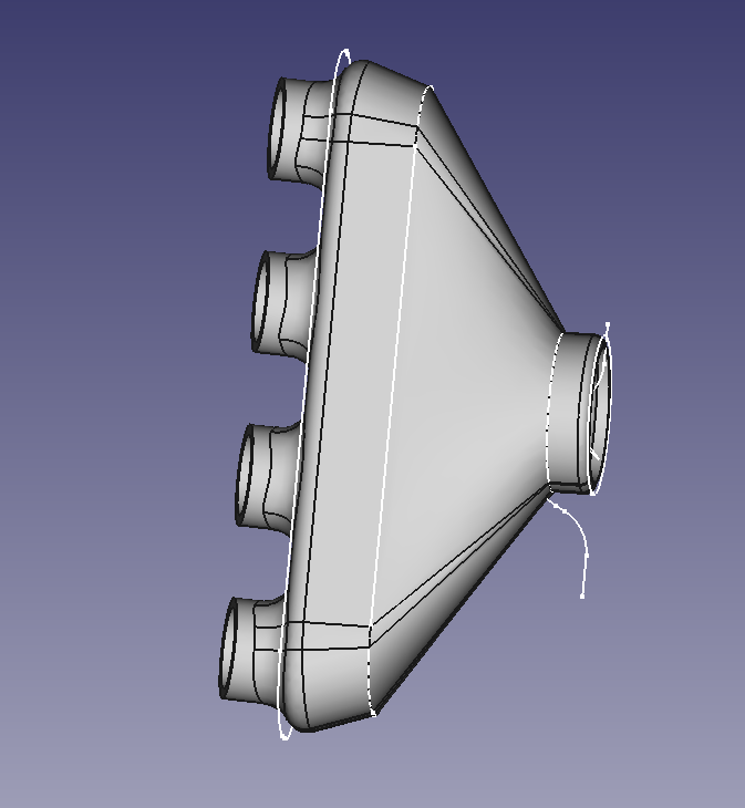

3d Printing a carbon fibre nylon plenum:
- 21,883
- 9,476
Very cool build.

Due to the steering shaft in the way of the TB I am thinking of printing a 2-1 TB boots to connect the TB's to the plenum. This will mean 2 less hose clamps to secure the boots to the plenum, along with allowing the plenum to become about 60mm narrower in width.
Also started drawing in fusion rather than freecad.
Does plenum volume matter on an ITB boosted unit? OR can the plenum volume be as small as possible ?
pulsar GTx2867 is ordered and on route with .82 stainless dual vband ex housing
had some layer shifts on the print as can be seen however this is just a mockup/test run of print settings.

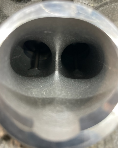

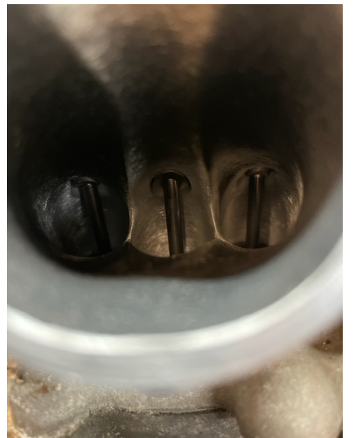

wimpy sidewinder intake port for comparison

Make the plenum as big as you possibly can. To small of a plenum will result in supersonic air speed which causes the air to be heated. You need a plenum twice the volume of the engine cc.

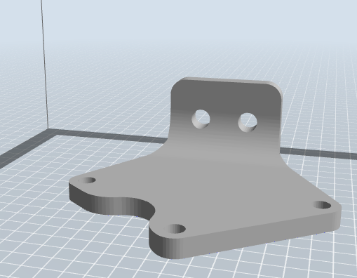

Almost got the apex wiring harness reconfigured. Should have this done in the next day or 2.
I ran the relays and fusebox up in the nose of the sidewinder. Some wires like speedo still need to be made longer.
Made up a bracket to print to attach the stock Apex gauges to the bars.

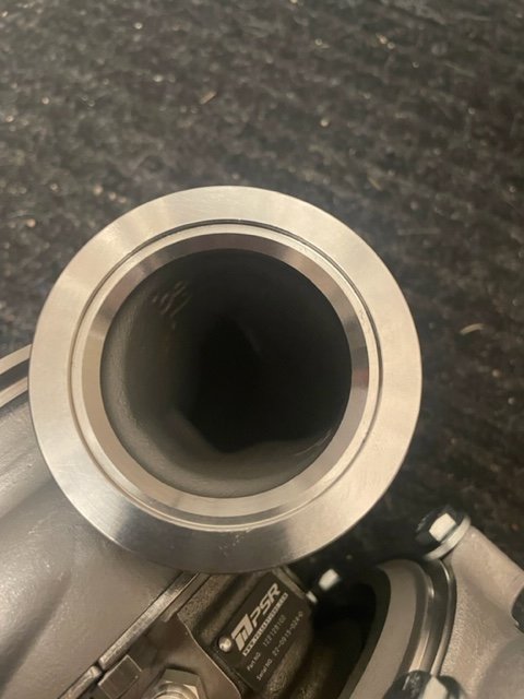

Pulsar turbo and 1.5 inch .065 304 stainless bends arrived today. My plan for the exhaust is to run a 4-2-1 header setup, kind of like the factory apex system. Doing this will also save space under the fuel tank as cyl 1 will merge into cyl2 almost immediately after turning 90degrees. 3 and 4 will also merge at a similar pipe length. I will try to make it almost equal length. I am using 1.5inch .065 stainless 304 for this. My primaries and secondaries are 1.5, then i will do the final merge into 2.25 and use a 2.25 bellows. (Does that seem too small? It should keep velocity up? ) The turbine inlet is a 2.5 inch vband and I will transition a cone to 2.5 right at the vband inlet, however after the vband the inlet into the turbine is already down to only 2 inch so i think a 2.25 pipe would be large enough?
Pictured is a 2 inch pipe ontop the turbine inlet.
Merging the 4-2 should also save some weight over a 4-1 header. This will also make packaging easier.

Is the 1.5" header tubes ID or OD?
Make the plenum larger, as big as you can.
