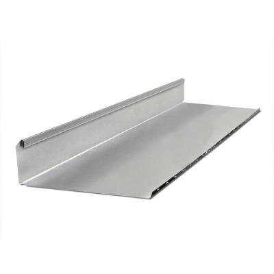

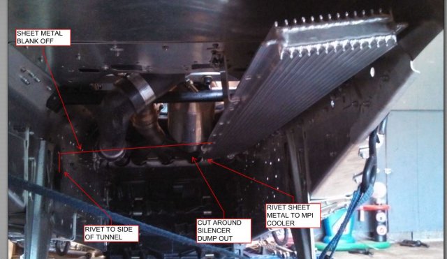

I ended up making a tunnel block off plate this weekend to see if it will help with all the icing. The plate is a little rough right now but if it works I'll make a better one this summer. To help simplify the process I bought a 16" x 8"x 48" 90 degree bent piece of ductwork from Home Depot for $15. Basically it's 2 sides of a square piece of duct.
I cut the the 8" short side down to 3/4" and used it as a mounting tab to rivet to the left side of the tunnel. This way I didn't need to try and make the 90 degree bend. I had to notch the 90 degree bend in spots to avoid some existing rivets.
I then cut the width down so I could rivet the right side to the plate heat exchanger & being sure to leave a small gap so the plate can rub on the exchanger (It shouldn't matter with the plate riveted to the exchanger but just to be safe).
Once the plate got to the rear of the sled just before the drop bracket and the rear exchanger vertical mount I trimmed both sides of the plate in (left side 1/2" to miss the drop bracket & the right side by 3/4" so it can fold up & be riveted to the top of the tunnel).
With the push turbos exhaust being dumped under the tunnel I also had to cut a opening in the plate to allow the silencer to stub out of the plate and into the tunnel.
I talked to Matt at MPI and asked him if he thought I would have any cooling issues now that the top of the heat exchanger is blocked off and no snow will get to it. He didn't thing there would be an issue since their cooler is so large. Before I but the plate on I was running 154 degree with the scratchers down and as soon as I jumped into some powder the temps dropped to 140's. Now with the back of the cooler still open I should get some snow thrown to the top side of it.
You can't tell in the picture but I stopped the plate just in front of the Y-pipe in the header so some of the heat can still escape from this void and typically I haven't had an icing issue in this area.
I'm also you to spray the plate and tunnel side walls with the cheaper yearly application of "Sure Foot" . So with the plate and that I should have the icing fixed I hope.
My only other 2 concerns are:
1) with the plate going all the way across will this cause excess heat ?
2) also with the plate all the way across it puts my turbo charge tube in this tighter space with the exhaust. Will this effect the temp of the incoming air and make iot too hot or effect performance?
Now to get out and test it.

Well my blank off plate never made it to testing. After I thought about it more it was a bad idea to have the charge tube in the same "chamber" as the header & hot air. Plus the turbo is designed to have snow thrown on it to help cool it. Now try not to laugh too much about my proto type (I'm still trying not to) I'll be testing it this weekend & if it works all make a nice one out of aluminium. Here are pictures before install and after.
Now this should be better for the sled but not as good for icing but better than nothing I hope.

Well I ended up having to pull my MPI heat exchange and relocate it farther forward about 3-1/4" to be exact. When the rear suspension was fully compressed the track would just barely rub on the inside 3 ribs of the heat exchange. I put 200 miles on and just a little of ware was notice.

So the initial location I had my the MPI heat exchanger mounted was not forward enough in the tunnel and after 200 miles I notice some rubbing on the end of the cooler.
To the best of my knowledge the cooler was mounted in the relatively correct location and at this time my paddles were only 2". Once I install my new 2.6" PC the rubbing will only get worse so I had to relocate the cooler. Now remember I have a Cat M-Series so it is possible that the stock Nytro MTX track might not rub so this is no fault or complaints about MPI's cooler. The height of the cooler was fine since it couldn't go any higher anyways.
I left the tunnel drop brackets and side mounts for the cooler in their current locations connected to the tunnel and just drilled the rivets out to the cooler.
Once I found the forward most location I could mount the cooler, I marker the new mounting locations on the cooler and drilled them out. I was able to shift the cooler roughly 3-1/4" farther forward. In this picture you can see the old mounting location vs the new one.
Since the cooler is rigidly mounted I was able locate the cooler with in 1/2" of the header.
For future reference to anyone mounting one of the MPI coolers, you can mount it roughly 4" from the tunnel / heat shield.
Now I have run this new set up in the UP with my new 2.6" PC track for about 100 trail miles and 100 miles off trail and it works great with no rubbing or issues.

As for the tunnel icing with the rear mounted Push Turbo I think I might just be screwed. The small heat shield seems to work some but I will need to get complete closure from the tunnel to the turbo but my main concern then is keeping the turbo and not trapping the heat around the turbo.
Existing heat shield, now I did put a divider wall between the charge tube and the header. Basicly this did nothing for me LOL.
This was my old design I never tested because I was afraid of trapping the heat around the turbo. I think it would of worked better for the icing but didn't try it.
One day I coated the tunnel with some DuPont Snow and Ice repellent and it seemed to help some.
But as of so far this has been the very best tool for excessive tunnel icing.

Now has anyone used one of the skinz light weight seats that removes the rear tunnel shrouding around the exhaust and in my case the turbo? And how is the heat from this.
Now if I went back to my old tunnel blank off design and one or these seat set ups it should keep the turbo cooler in my eyes. Any ideas or pointers would be appreciated.
