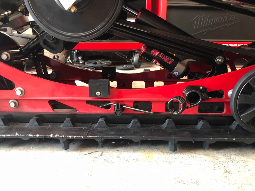

For this year I switched out my ice scratchers from the tunnel ones to the BRP rail ice scratchers. When I took my skid out this year, I noticed the bolt holes on the hanger for the upper iddler wheels were egged out a bit, which concerned me, so I am going a different route this year to see how these work. I only had to drill one additional hole which was nice.

What's the part number on those - want to try them on my procross.
BRP 860201728

I have the same ones but I mounted them 1 inch back from where you did!! My upper wheel hit and broke the plastic holders!!For this year I switched out my ice scratchers from the tunnel ones to the BRP rail ice scratchers. When I took my skid out this year, I noticed the bolt holes on the hanger for the upper iddler wheels were egged out a bit, which concerned me, so I am going a different route this year to see how these work. I only had to drill one additional hole which was nice.
I think you sould be good where you mounted them!!!

Dang, I didn't even think about that when I mounted them. Hoping the location will be ok and the holder has enough clearance from the wheel.

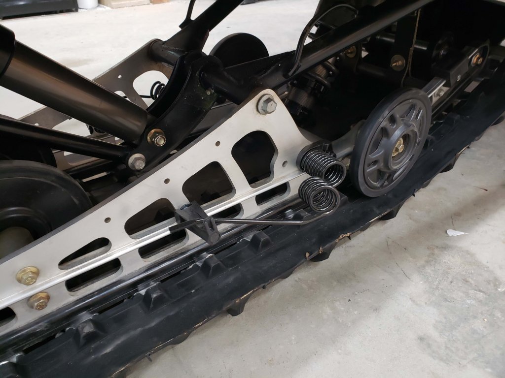

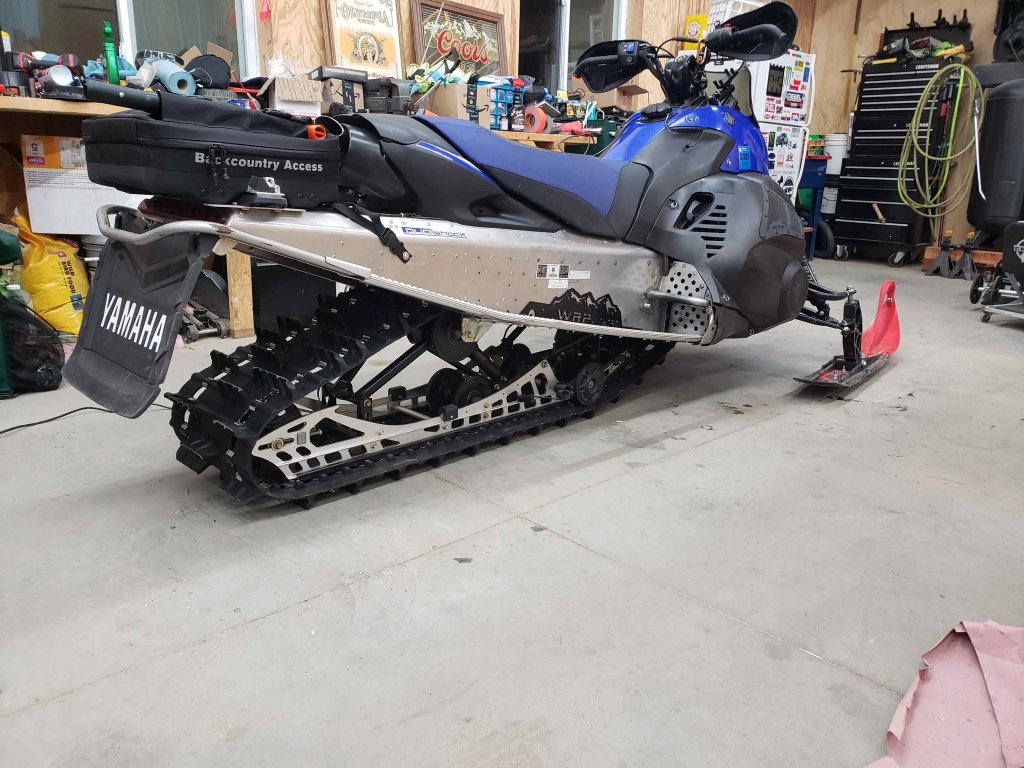

I know it's on a Nytro but I've been pretty happy with the set of BRP skid mounted scratchers on my XF skid conversion. I did break off one of the tips on the plastic holder riding off trail but that's to be expected. I put a zip tie around the skid rail and ran it like that for the rest of the year. I think I'll replace the hangers with some short bolts before this upcoming season.
These are a bit more expensive than scratchers I've ran in the past but they seem to work well. I liked my last set of Kimpex footboard ones as they throw a lot of snow way up front on the skid which is great. I did have to add some thin rubber sheets to dampen the vibration on the footboards, but had to go a different route with the WRP inserts I installed last year and you can't back up with them... I didn't have good luck with the cable scratchers. Seems like they don't provide enough down pressure bite and I broke the end off one in less than 100 miles...

Hows it ride with that skid in it? I have been thinking about doing this to my nytro rtx se.
