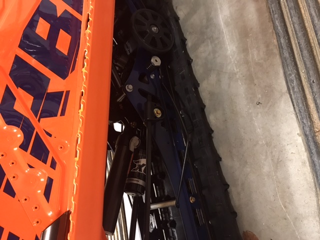

Hows it ride with that skid in it? I have been thinking about doing this to my nytro rtx se.
I'll be completely honest in that I don't have a ton of trail miles on it yet, and not being able to ride it back-to-back makes things tougher for me personally to compare since I'm no sled setup expert. I researched a bunch on Viper skid settings (mine has a float shock in back) to start with that as a baseline and I've slowly been tweaking it a little at a time from there. I'm plenty happy with how it rides considering the change from from a torsion spring setup to float shock.
There are several things I can comment on with certainty.
1. Even through my rails are raw aluminum this XF skid holds considerably less snow than the original Nytro setup
2. Weight savings of 30 lbs. - my stock skid in full dress (torsion spring spacers, X wheels, etc.) weighed 73.8 lbs. and my XF skid weighed in around 42 lbs. (I forget the exact weight and couldn't find my picture...)
3. Rear suspension sag has been eliminated - no more sag while the sled is unloaded

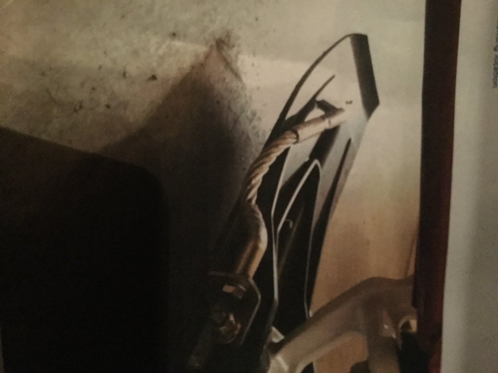

.... Why have things tangling from the skid or tunnel until you use it?
These SLP control arm scratchers are the Catz Azz.... Why have BRP crap hanging underneath, they wear quickly, rust and risky getting hung up in the track.... Fuzz that crap... Go with full stainless steel cable with replaceable Woody carbide tips.... Also they fold over when reversing and won't break like the BS BRP ones, .... They also install in seconds, no tools required .... When not in use, carry them in your trunk bag or make a storage clip under the hood.

Very functional location, I emailed them to ask if they had a bracket to accommodate the 2 hole Duraflex scratcher mount system
