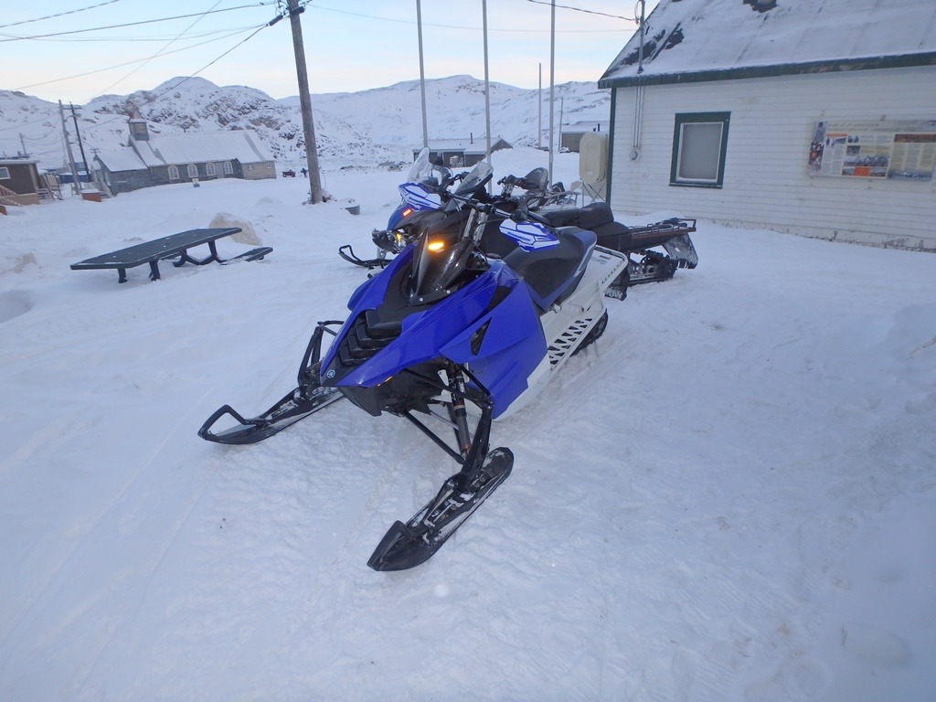

So I figured it has been long enough now that I can give an update and a ride report. First I will start with the bad(not really bad just what it is)
The Bad
1 - Froze the A/O separator and puked oil on ground. I am looking into ways of deleting this now. Of course it had to happened when I was out of town doing SAR training, my fiance was distraught when I came back to town. She figured she blew the machine up, and of course me being the dick that I am I had to stroked it for a bit, put the screws to her and play the "OH MY GOD" "WHAT DID YOU DO" card. I got a slap when I told her I was expecting it to happen and it was not a big deal, I just didn't know when it was going to happen. Ha good times. Oil Press sensor saved the motor.
2 - I am not completely sold on the elimination of the sway bar. I think because of the FOX air shocks low initial spring rate there is quite a bit of outward dive in the corners. If I remember correctly I am at 250PSI on the Hygears and 100PSI on the main chambers, and it still dives a lot from side to side. I am going to keep going up in pressure until the ride is too harsh, and then make my final decision.
3 - The Factory rear suspension isn't really happy hitting big bumps and taking hard landings, granted the shocks have not been replaced yet. The rear, bottoms out a fair bit. I hit so hard once that I had to get off after it and check to make sure the front cross shaft wasn't sheered off again.
4 - I believe with taking so much rotating mass off of this sled it is now massively under clutched, damn near any time I get on the throttle hard, it instantly hits the rev limiter. Time for a clutch kit.

I have not checked into the short yet, to this point it hasn't been a hindrance, might be in the future though. I will rectify it one day, hopefully that's not procrastination that bites me in the A$$.Sounds like something is shorting out and/or your IAC sensor is not working correctly I would try to trace the harness looking for any added/spliced/rubbed wires. As for the altimeter did you calibrate it with the mode function?
The fuel sending unit was hung up on the fuel pump intake screen. So it was stuck in one position, works now.
IAC trouble code po509, lets just call me a bone head. I missed plugging the IAC in when everything went back together, no more codes being thrown.
