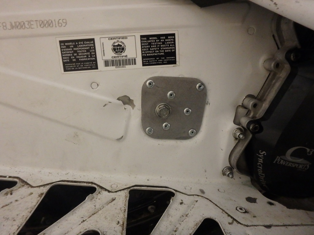

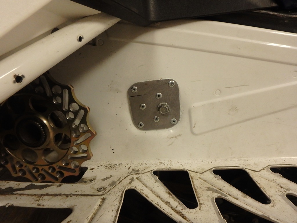

new tunnel support plates 1/8 plate steel riveted with cherry rivets and glued with some urethane caulking will strengthen tremendously where the tunnel was all beat up from the cross shaft breaking

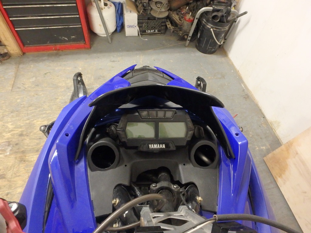

new gauge idea if i turbo then the gauge pods on each side will be a good spot for Boost and AFR gauges

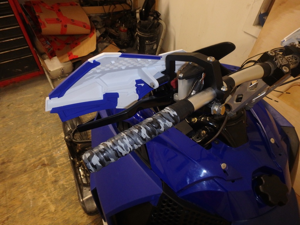

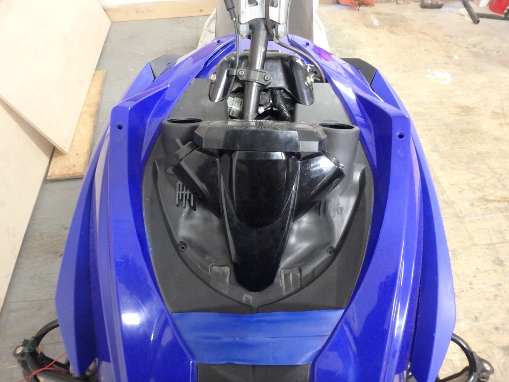

Gauge and windshield mounted. 5 rivets and she is good, not that great for a trail repair but oh well.
Hand guards, heaters and grips on as well. I like the feel of the RSI grip wraps but I am not really digging how much white is in the hand guards, they might have to be changed out to all black ones.
I just need to finish up some wiring, mount the starter, fill with fluids, cross the fingers and then hit the key and see what happens.
