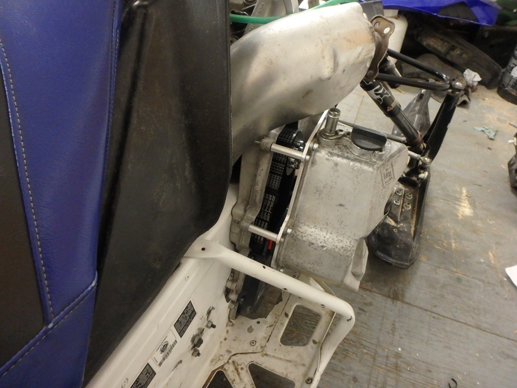

Pics don't lie. My shop is still dirty but workable, sled supporting it's own weight, still need to do a bunch more work.

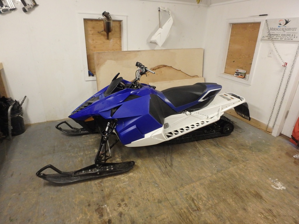

this is how I think I want the sled. No gauges, no dash just bare bones. I have some sheet black plastic that i could possibly shape into a cover for under the wind shield to hide everything, but???

You need the gauge, seeing low oil, high temp, etc I couldn't live without that peace of mind.  I also don't think your hand warmers will work, maybe some other stuff as well with the gauge unplugged.

Ok, I got to ask. What is the benefit of having a belt Vs the stock chain case? Better gear ratio? More reliable? I have seen people do this before, and am just wondering if there is any improvement or not over stock.
I was thinking about the safety the gauge cluster has but what I originally thought was to use 2 autometer gauges 1 for pil pressure 1 for water temp and put them in the gauge pods there. But in all reality there was no benefit to doing that so my new thought is mount the factory gauge under the wind screen (shown in the pic). I did a little more work and I also just ordered up a new starter, belt, RSI gel grip wrap, bar warmers, and hand guards.

I went with it becaus
I went with it because it cleanly eliminates reverse and it is also a lot lighter. Is there a benefit, probably not. I read about a turbo'd machine putting 600hp threw it though, so that tells me it is plenty strong.

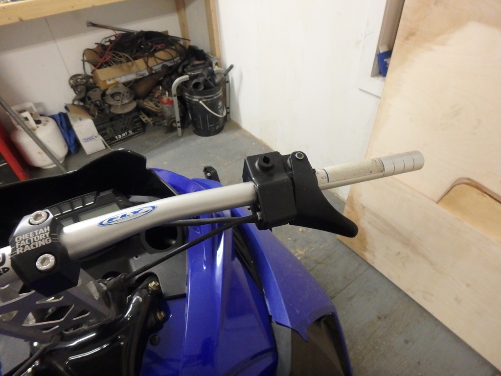

throttle block ala vk540, way smaller and cleaner than the original. still have to figure throttle over ride whether it is normally open or normally closed hopefully i can just disconnect the wires and it will run if not i will have to make a small jumper wire still need to cap where the old kill switch was
