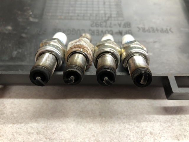

Ok. I have the carbs back in and there’s a changed in the problem....sorta. Still idles fine and I could get it moving but it starts to run rough and bogs at around 4000-5000 rpm. I decided to pull the plugs to see what they look like and this is what I saw. I’m no pro at reading plugs but it looks like it’s running rich. What’s your thoughts. I put my old spare in and they were tan color. Now it bog just off idle again. WTF

Hey bud,not sure if you have had time to work on your running issues but had a question have you checked your coils?(in a dark area looking for arcing)also you were going to check the tors bypass to verify it was correct & wiring ok etcOk. I have the carbs back in and there’s a changed in the problem....sorta. Still idles fine and I could get it moving but it starts to run rough and bogs at around 4000-5000 rpm. I decided to pull the plugs to see what they look like and this is what I saw. I’m no pro at reading plugs but it looks like it’s running rich. What’s your thoughts. I put my old spare in and they were tan color. Now it bog just off idle again. WTF
stomper
Haven’t had much time lately but yeah I did the coil check in the dark and it all looked fine. I’m going to do some checking on the fuel pump. I really think it’s not a carb issue anymore.
