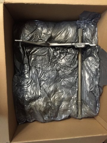

Yamaha kit part number please?
Here complete shaft. Does NOT include chain case bearing or clip. $200

Under the Yamaha sticker we can see the Arctic Cat parts number 1702-???
Chain case side of the shaft seem to be identical to my upgraded 15-16 shaft.
