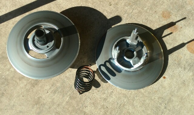

Is there a reasonable amount of belt slip? 8jp belt
KnappAttack
- Feb 19, 2004
- 5,008
- 6,360
- Welch MN
- 2023 Sidewinder LTX-LE
2017 Sidewinder LTX-LE
You can have perfect clutching on a four-stroke and have that. Generally the belt will put hard marks on the clutches from letting off. Black marks do not always mean its slipping on the upshift. Keep in mind when you let off with a torsion secondary, only the spring will hold the sheave against the belt. The helix basically releases all pressure from the belt, until you get back into the throttle and it applies pressure to the belt again.
I wouldn't get nervous about some streaking as you have here really. Stock I assume?

Yes, Mike all stock. I didn't want it to grenade at speed.
