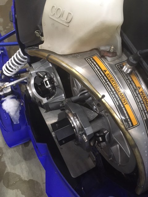

Anyone else seeing this? Rode with a guy on an srx and he had the same issue. By my simple measurement it is about half way through the panel.
Best solution?
Best solution?

i used a feathering disk on my grinder and shaved it off. Eazy Peezy

Before I bought my SW I had read this was an issue so before I ever rode the sled I addressed the issue and have had no wear at all on side panel.

You just haven't blown enough belts yet lol.
- 2,489
Bend it down, grind/cut it shorter/edge protect it.

Bend the edge down work’s nice.

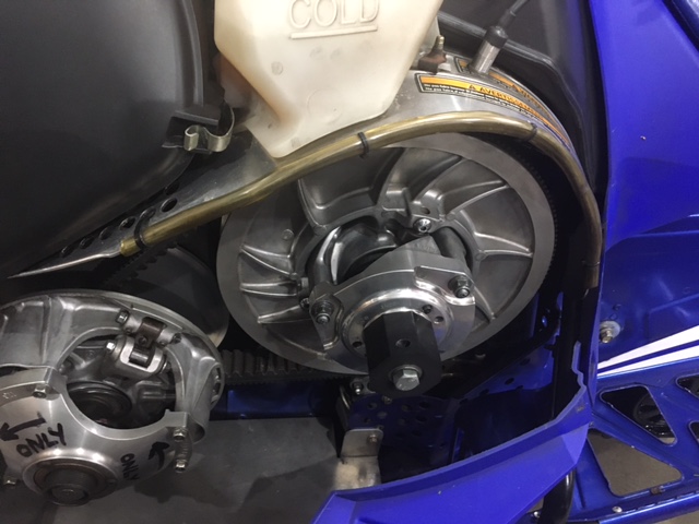

Put the big washer back on the secondary.Before I bought my SW I had read this was an issue so before I ever rode the sled I addressed the issue and have had no wear at all on side panel.
View attachment 170464View attachment 170465
sideshowBob
I float my secondary so I need to leave the big washer off for additional clearance from belt adjuster.Put the big washer back on the secondary.

I used the same stuff, been on since 20 and hasn’t move.i wondered if anyone else's rubbed! i just put a piece door guard molding on i had layin around
