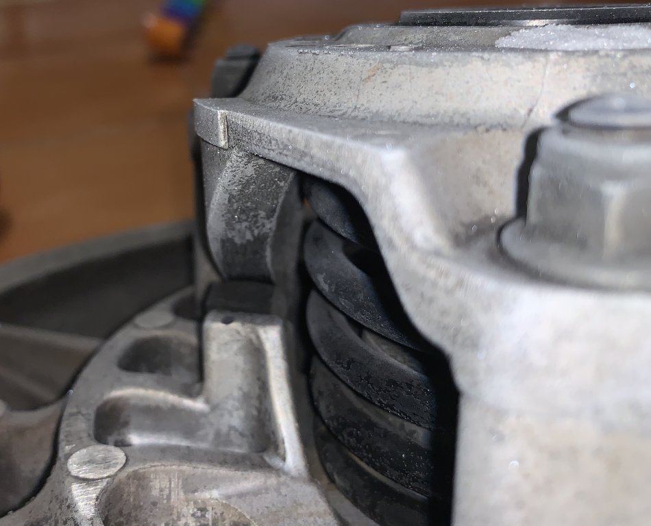

PrimaryI’ve posted on here before about this issue but im still have problems. Basically when i hit 15-20mph something happens, its like im stuck at 15 until i hit the throttle and get up to 25mph, then everything was fine. Well now its still happening but its also happening at higher speeds. I talked to a friend today and he mentioned maybe its the ramps on the secondary or the weights getting stuck on the primary. Thoughts?

This a ramp?I’ve posted on here before about this issue but im still have problems. Basically when i hit 15-20mph something happens, its like im stuck at 15 until i hit the throttle and get up to 25mph, then everything was fine. Well now its still happening but its also happening at higher speeds. I talked to a friend today and he mentioned maybe its the ramps on the secondary or the weights getting stuck on the primary. Thoughts?

That does make sense. I just blew a crap ton of dust out and now im going to finish xleaning the secondary. The primary feels rough to the touch.when the belts wear the dust they shed goes into the clutches causing them to bind up or stick. blowing them out at least a couple of times a year helps to keep them from binding/wearing with the dust.
there comes a point, milage/hours wise, where the bushings in the rollers and weights wear out and need to be replaced. if the rollers stick, they get flat spotted and cause the weights to wear funny.
some motors cause the weight to bounce on the rollers causing lines on the weights witch cause odd shifting/operating issues. weights should be smooth along where the roller contacts for the most part as there are some weights built with a bit of a notch at the idle area from factory or for racing.
