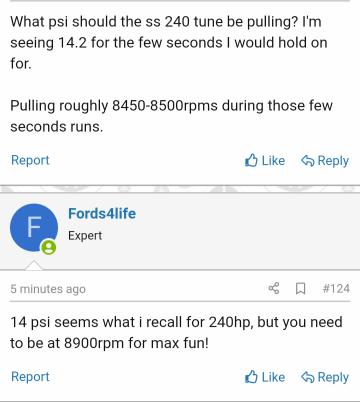

Theres alot more to a tune then boost. Timing being a MAJOR player. Remember when evo made tunes? Believe they had 58hp gain at 14.7psi.I'm going to debunk your theory. You say the 240hp by Hurricane is the same as the 260hp horse by TD.
Yet the 240 horse by Hurricane only makes 14 PSI and the 260 by TD makes approximately 17 PSI. Please explain.....

Understood....I also would consider 14psi to be on the low side of the spectrum when talking about the 240ss tune.Theres alot more to a tune then boost. Timing being a MAJOR player. Remember when evo made tunes? Believe they had 58hp gain at 14.7psi.
Then there's the matter of 2bar vs 3bar, etc. Right on.

The super spool tunes run more boost down low and at wide open boost is adjusted to Match that tunes rating.
For example, 240ss could be pulling 17psi boost during acceleration up to a certain rpm then boost is reduced to the 240ss rating at higher rpms or 270ss rating and so on.
