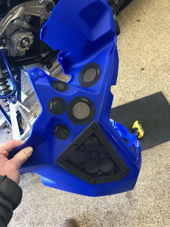

Maybe a little overkill, but Swiss Cheese is one of my favorites.IMHO your wasting your time.
Let some air in with a vent, get your offset right, make sure your clutches are in good shape and throw a ultimax belt on it. I personally don't know of one Cat guy having an issue with belts, I'm sure there is some but I've not seen one. I have however seen a lot of SW having issues.
That will work good Art till the first belt blows and wipes it all out. Bring duct tape in the trunk for when that happens.

<sigh> yeah, God I hope to get these belt issues behind me. But I have Prevost's clutch guard that wraps all the way around, I think (hope) it'll be ok.That will work good Art till the first belt blows and wipes it all out. Bring duct tape in the trunk for when that happens.
