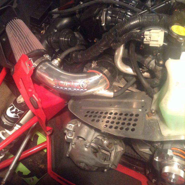

We did after reviewing the cost of making them in quantities. I also dropped the price of the TD stock modified exhaust.TD dropped their price to $199 CDN so I snapped one up with the 10% discount on top of that.
I too use K&N filter which is the same as we used in the 1100 turbos. High quality high flow, and it fits really nice.
We use regular worm clamp which are lighter and easier to install. This tube has no pressure so Tnut clamps are over kill.
The bend we use is optimal for flow. But there are other intakes I see which will work equally. This is not a very difficult part to build.
This is a great part that someone can actually do themselves given a few tools and parts contacts.

Don't mind the picture on the webstore, the new intakes are nice and we use a black silicone tube not a blue one. That was the prototype on my own sidewinder. I basically did all the testing and legwork to prove that intake flowed and made power.
Now you see immitations of it. Which is OK... easy piece to make.

TD cold air intake installed.

TD design looks great!
Nice to see a fully working kit with both vent tubes hooked up.
