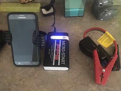

May be 3.9 in the package. But 3.13 ready to install. I picked it up as its same size as OEM and about 9 pounds lighter. No fabing anything to compensate for a smaller battery. Had many lightweight batteries in the ole SCApex. Cold days initial start most always had to use jump box. Im sure lithium different story, but wasn't risking it without more reviews. Had a lithium in my atv for years zero issues. Smaller, lighter, cheaper, more cca….Im in if they actually get good reviews vs. how they suppose to perform. One season on the 36D, zero issues, zero need for jump box.
My jump box is small and packable, but prefer not to need it for use on my own sled. Prefer to bail out my buddy's.
