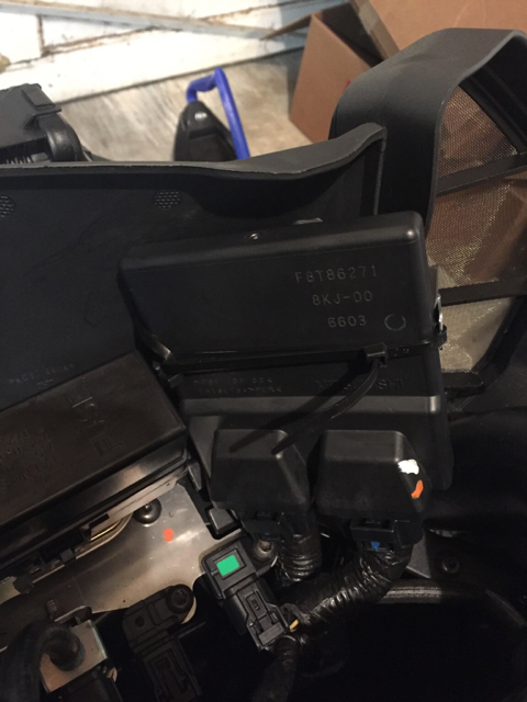

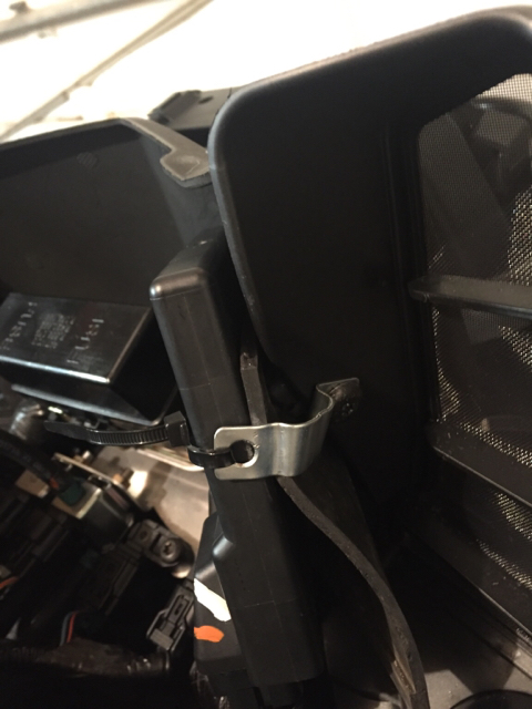

Not sure if you posted in the other thread..I can't remember which one it was. But do you have any pics of how you relocated ECU?
@shagman has them on his phone

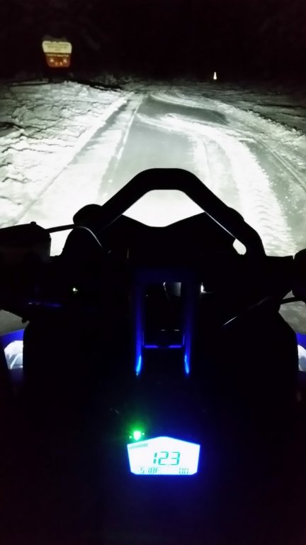

This is my testing grounds. For those that know this area...it's about a 1/2 mile to the stop sign so I run a 1/4 mile marked off with a red ribbon so I can make sure I stop at that stop sign. This pic is from Saturday morning at just after 6am.
Plus, I have timers, Speedcheck radars and spend a lot of time clutching, suspension tuning and other mods to get these mph's.

That's a cool pic!!View attachment 125513
